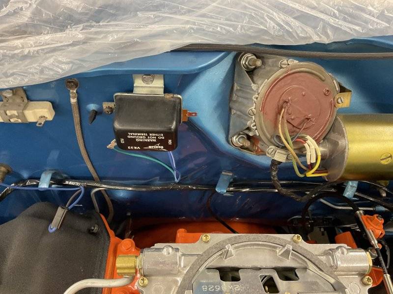

Ok so your dash ground is good then or they wouldn’t work. Is your engine to chassis ground present
Is there a place this is typically located because I am not seeing one. I could just be missing it.
It should be bolted to the firewall and attached to the back of the right head. Look between the ballast resistor and voltage regulator on the fire wall and it should be bolted to the firewall and run down to the head.
Here I have a pic of where it should be. You can see it between the ballast and voltage regulator
