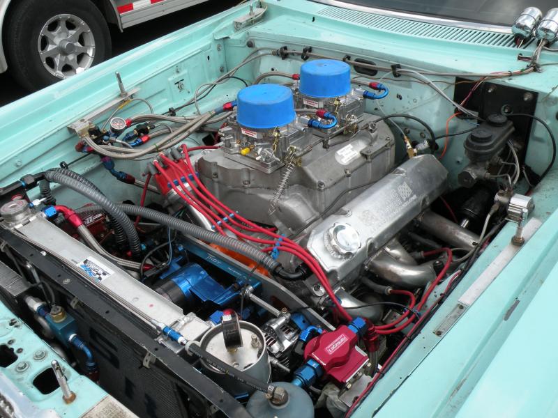

This is where i mounted my moroso accusump. I hated seeing it and didn't want to mount it on my inner fender.

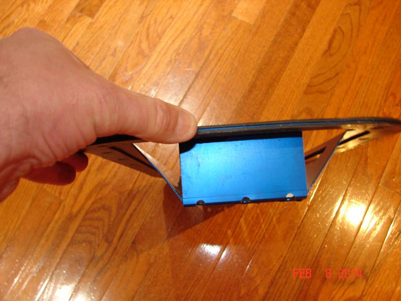

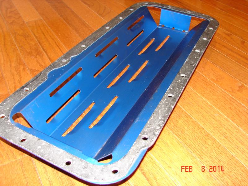

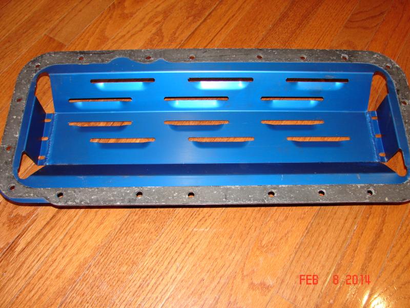

Kind of possibly sounds like you need a baffle built into & in the pan around your oil sump/pick-up to keep the oil pick-up submerged better, stop oil from running away from the pick-up when you do them big *** wheelies & hard breaking, along with a windage tray, probably wouldn't hurt... what did your engine builder recommend ??... Milodon has one advertised for up-to a 1" stroke {would be 4.75", they run alum. rods too}, Fueler type Windage tray #32055 saw it on their website... www.milodon.com/oil-system/windage-trays-studs.asp... will not work with street strip type pans, needs to be an open pan like a F/C or T/F car has... {I've never used it thou} if not them try BAE www.bradanderson.com/ or Allan Johnson Racing {AJPE} www.alanjohnsonperformance.com/ or www.Racecarparts.com/ or Steff's Fabrication or Ray Barton Racing or Keith Black Engines or Dan Olson or Canton Racing etc.
Kind of sounds like you need a baffle built into & in the pan around your oil sump/pick-up to keep the oil pick-up submerged better, stop oil from running away from the pick-up when you do them big *** wheelies & hard breaking, along with a windage tray, probably wouldn't hurt... what did your engine builder recommend ??... Milodon has one advertised for up-to a 1" stroke {would be 4.75", they run alum. rods too}, Fueler type Windage tray #32055 saw it on their website... www.milodon.com/oil-system/windage-trays-studs.asp... will not work with street strip type pans, needs to be an open pan like a F/C or T/F car has... {I've never used it thou} if not them try BAE www.bradanderson.com/ or Allan Johnson Racing {AJPE} www.alanjohnsonperformance.com/ or www.Racecarparts.com/ or Steff's Fabrication or Ray Barton Racing or Keith Black Engines or Dan Olson or Canton Racing etc.
those seem to be out of production.unless I'm wrong.
summit & jegs don't list them anymore.
not sure about Jegs or summit, but it was on Milodon's site still, maybe call or contact them directly, I know they are/were steel & heavy too thou like 5.1 lb's...
I think Canton will custom make stuff like that.
I don't know think Copperhead is in business anymore. Might check the classifieds here:icon_thumright:

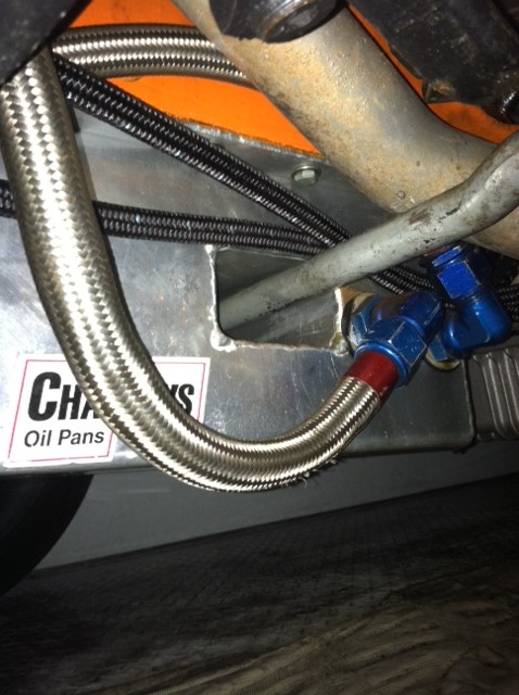

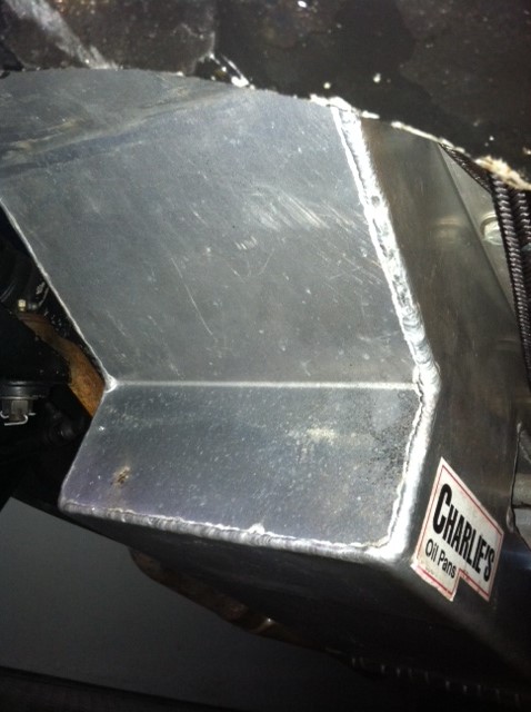

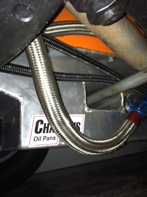

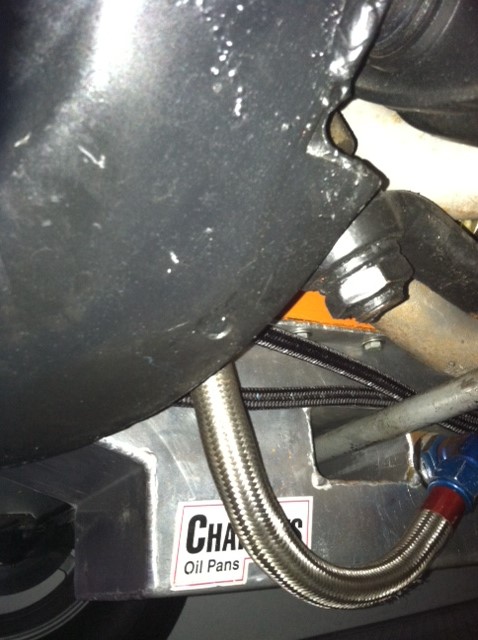

Chris,
I don't know if you're going to be able to run the windage tray with the Charlies Pan. He runs a screen that bolts inside the pan right at the level of the drag link tube. You may be able to make it work but you might want to talk to Charlie about it while the pan is back in his shop.
Just a thought.
Chris,
Just a thought.
Charlies building me a new pan. he admitted he made a mistake. he's making me a new pan just like my hemi pan. with pickup in the rear.
