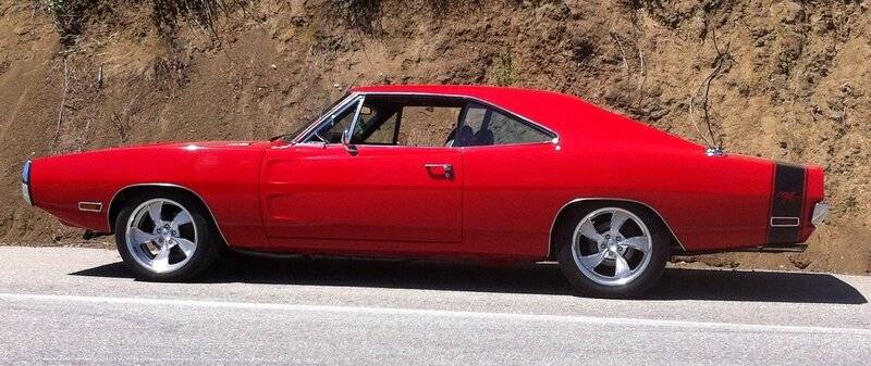

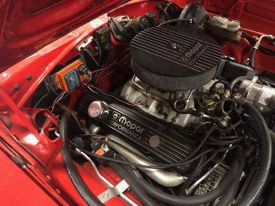

Strange thing...
This car....
With this induction...
Can sit for 2 weeks or more and still fire up after less than 10 seconds. If it is within a week, two pumps and it will start.
