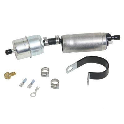

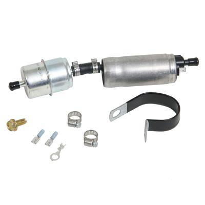

Yes, yes and yes. The electric charge pumps won't force fuel down the carb and into the crankcase though. As long as the pressure isn't too high and the needle/seat and float are all operating properly, the fuel will be shut off when the bowl is full.Hello everyone, long time reader but not much of a poster. Great ideas, they will all probably work for one application or another. As posted, it's a heat soak problem and once in a while it will even happen to our shop car if occasionally using a lower grade fuel if the station didn't have a better grade.
