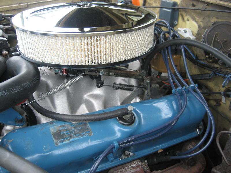

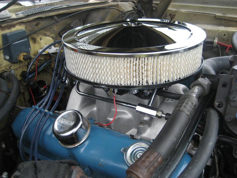

I had same problems with mine. Found Carb was leaking fuel around throttle shaft and vacuum leaks with carb and intake leak at front. Behind all the ac stuff. Took forever to figure out. Also throttle cable wasn't far enough forward. I got a 4 bbl intake and carb setup from Summit with electric choke. 004.jpg005.jpg008.jpg001.jpg
