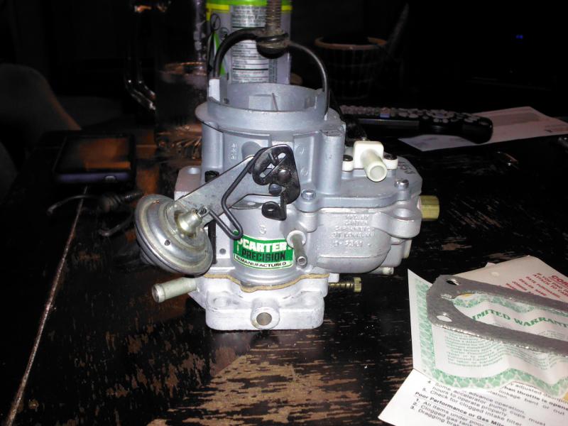

Well here it is got it off eBay and I'm pleasantly surprised its actually a carter precision reman with warranty and all gonna go bolt it up. After that I'm gonna try something else I just thought of I am going to find actual tdc with a piston stop tool and make sure my balancer timing mark is correct maybe when I checked that and found it was so far off my timing mark was wrong. 1371919455570.jpg

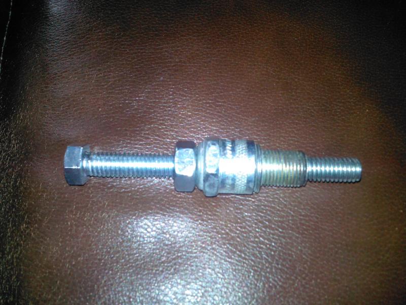

OK well Carb is on needs tuning before I drive as it starts sputtering when I put it in gear but it fired up fast and ran good the fast idle before choke comes off is even working good. I just finished building my tdc tool as Napa, car quest, or anvance auto could not get one in a timely manner or some at all. It wasn't too bad I'm gonna post a thread in tool section for anyone who wants to build one. 1371929292555.jpg
OK after checking my tdc I discovered my mark was not accurate but wasn't off by much about 5° btdc so my balanced obviously can never be trusted again as I'm sure it will move again. So I set timing to right around actual TDC and it runs good I even adjusted Carb with vacuum guage. So when you put in gear and come to a stop it seems to have a bit of a lumpy idle but doesn't stall when taking off from a stop or going around corners anymore. The only thing I notice is a bit of surging when cruising around 30 to 40 but not horrible. I'm wondering if I should retard the timing even more as it seemed to run better that way when I was setting timing. This whole thing makes me wonder if the engine has had a came change at some point in its life. Here is a question is there a way to set optimal timing with my vacuum gauge ?
