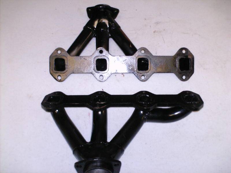

Or if I become convinced the modification avenue is impossible I may try to make some that will fit from scratch with 1 1/2 or 1 5/8 tube. I don't even care if they are a little funky as long as it's an improvement from stock manifold. Does anyone know more about this picture I found online? Seems like someone made some... question is do they fit? If so I'd probably try to copy them.
OK Evan, What did you end up doing for headers? I just recently got a '63 Dodge 330 & wanted to "play" a bit with her. I'too, found those overhead header for the newer Hemi, the ones I saw were for installing turbos, but came right along the valve covers then a "droop" at the back.
