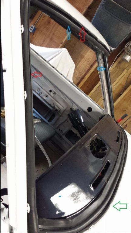

Did an internet search.
Boldly going where no one seems to have gone before on this.
Which way?
Should I put the glass in the gasket first then use pull the side and top rubber into the car?
Or put the gasket in the car first and shoe horn the glass into the rubber?
There is sort of a "zipper" channel (Red Arrows) that lets the rubber pull way from the glass for installation on the sides and top only.
It appears that once the glass is in the gasket, you zip the two rubber sections together.
I've seen something like this before.
I've done several A bodies from the 70s. They have a big lip on the inside of the car that you can't pull in with a wire.
The gasket goes in first. The windshield is then "shoe horned" into the rubber and a rubber locking rope goes into a channel in the rubber.
(Well, that worked for me anyway)
But to do this car maybe I should put the glass in the rubber (Blue Arrows), use 3M 8509 (or equivalent) into the cowl bottom gutter channel (green arrow) and 8509 in the side and top rubber groves that go on the A pillar and roof fences. And then set the assembly into the cowl channel.
Then use a wire to pull the rubber into the car on the A pillars and roof.
3M strip caulk (8578) appears too big and not pliable enough for the small groove in the rubber that goes on the fences. But I figure it needs something.
Already done the rear glass on the car. I've go some experience on that. Live and learn.

I checked the factory manual. (DUH) Should have thought of that, since I have one.
It instructs the gasket to go in the car first.
Like this.
Put 3/8 bread of sealant in the cowl trough and sealant in the rubber's fence grooves on the sides and top.
Also sealant in the rubber's glass groove all the way around..
Then put the gasket in the car.
Set windshield in the bottom groove and work in into the sides and top grooves.
The put the zipper thing together once the glass in the rubber..
I'm glad I found this because after looking at the rubber, the sides and top sure look too heavy and thick to pull them into the car. Plus I tested the gasket on the windshield and it really doesn't stretch and stay on like the back glass gasket does.
That one uses the rope pull in trick.
