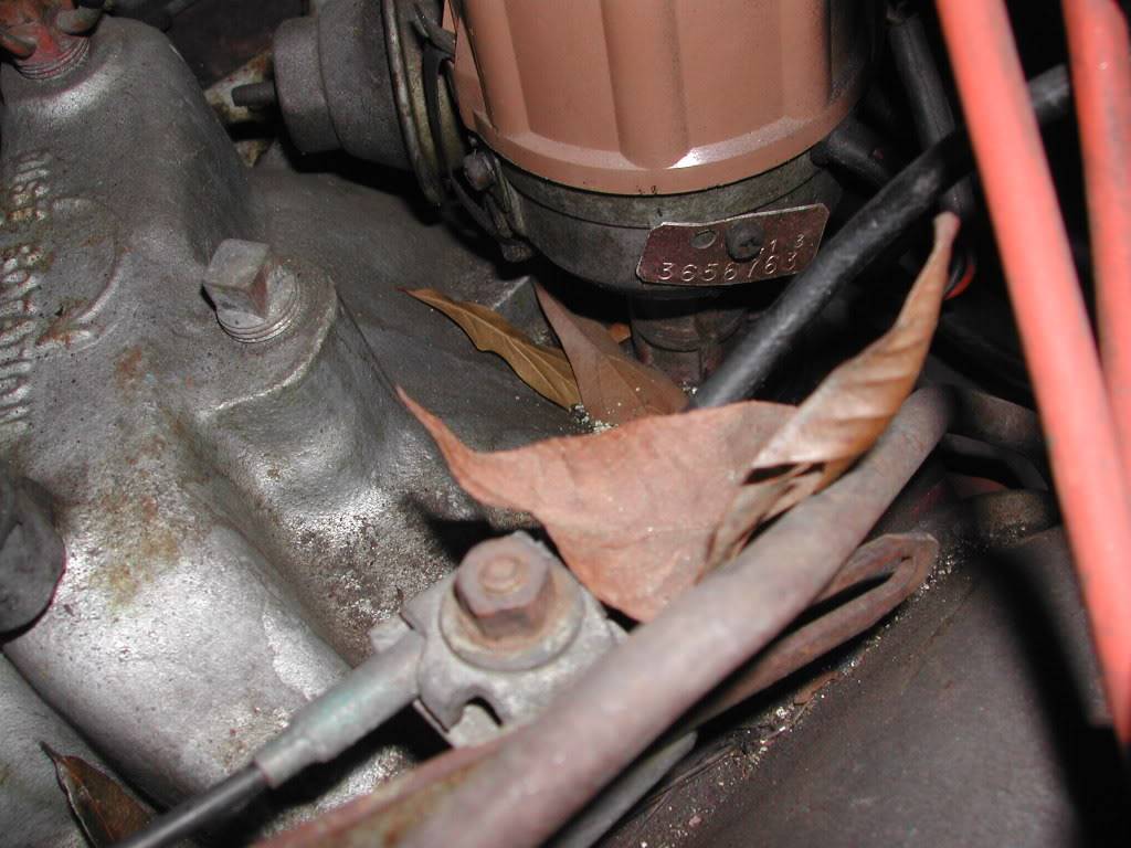

in your dizzy?
I had great luck with the application for a Pertronix I in my AMC 360.
I am thinking of throwing one in my 73/74 Chrysler dizzy and CH-181 comes up as the application.
installed one in my 383 Charger years ago, and have had zero problems.
I used a Pertronix Ignitor 1381A unit for years in the distributor of my 383 for years and years with out any problems. The one caution I was told with the older units is to NOT leave the ignition in the on position without the engine running.
