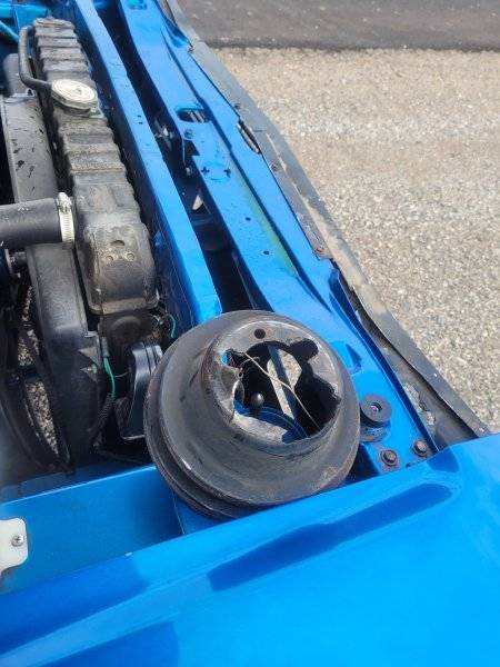

I have a 69 Coronet that we bought in 1997. On Sept 18, coming back from the mechanics I had a "major" engine failure. The temp
gauge pegged the dial twice, I pulled over to the side of the road. At that point steam was coming from under the hood. Thought I
had blown a rad hose. On lifting the hood, the rad hoses were still in one piece. The engine bay and under the hood were covered with antifreeze. Looked around to see what had happened and found the lower crank pulley resting on the passenger side to the K member. Fan blade was damaged. Any way has any one had the pulley explode. See attached picture.
Picture makes me wonder if the remaining bolt hole even had a bolt in it?
Good question. I do not know. 5 bolts were still attached to the damper, 6th one? Was able to find all of the metal pieces. May be a small crack grew.

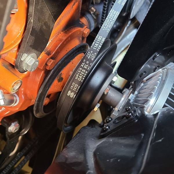

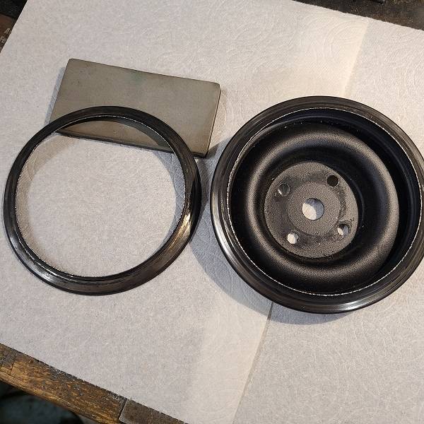

I posted this last year. Add me to the broken water pump pulley list. I took my road runner to the Goodguys car show at Pleasanton yesterday and won the Mopar muscle award. Had a great time but on the ride home cruising at 70 heading into a hard right turn on I 680 the steerining went dead and I'm heading for the divider, fortunately instinct and muscle kicked in and was able to wrestle the car to the right and finally get off the road. So I get settled down and popped the hood and see the belt is thrown, no problem I'll get the tools and reinstall untill I saw a ring around the water pump. I have never seen or heard of this so it took awhile to realize what I was seeing. see attached. The pulleys were purchased from Bouchillon and only have 2k miles on them. This incident has me rethinking the down side of the longer fast ratio pitman arm I have and the larger tires makes it hard to steer.
