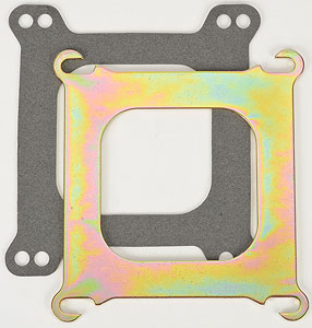

Which intake manifold are you using on the car? The reason I ask is if you are using a manifold designed for a spread bore carb (like a Thermoquad) the Edelbrock or any other square bore carb may encounter sealing issues under the base. Edelbrock offers a plate to help seal the base of the carb to the manifold.

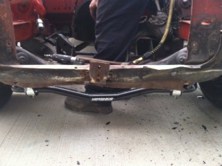

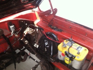

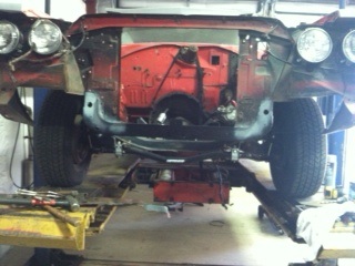

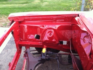

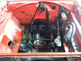

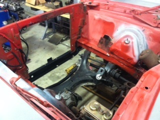

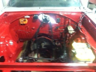

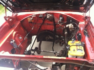

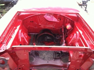

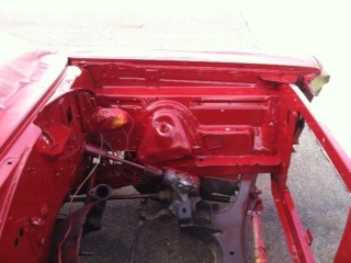

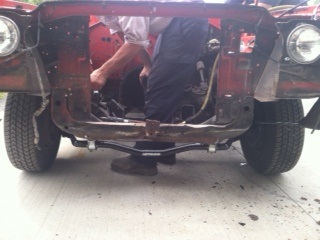

Been a while since I have posted just not enough time in the day. Since my last post I have pulled the engine, did a total rebuild, replaced the lower radiator support, prepped and painted the engine bay, rebuilt z-bar assembly, and had exhaust manifolds ceramic powder coated. I just buttoned up the engine so need to paint and put back in. I hopefully will have it running within the next couple of weeks and to paint after first of the year. Hopefully Dad will get it back by the time it gets warm out. Here are some pics of the progress. Will post more later.
Engine out.JPGEngine Out1.JPGLower Radiator support.JPGLower Radiator support 1.JPGNew Lower Radiator Support.JPGEngine Bay Prep.JPGGood Help.JPGEngine Bay Prep1.JPGEngine Bay Painted.JPGEngine Bay painted 1.JPGEngine Bay painted 2.JPGEngine bay painted 3.JPG
