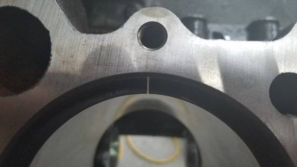

Curious what ring gaps did you go with?
I believe I used 0.019" to 0.020"
And the gap on the second ring?I went with .020" better safe then sorry. It will be a street engine.
Also .020"And the gap on the second ring?
On the big bores at rpm (about 4,000+), we found we were getting ring flutter and big blow-by until we opened the second ring gap to .025-.026".Also .020"
Yikes! What brand? Total Seal? Hasting's?On the big bores at rpm (about 4,000+), we found we were getting ring flutter and big blow-by until we opened the second ring gap to .025-.026".
I called the ring manufacture and told them and they said, "Yeah we know."
So I told them their instruction sheet still said to have a tight ring gap on the second ring!
Their answer was, "Yeah, we know."
What the heck! Do they have hundreds of boxes with bad instructions they are just trying to use up?
