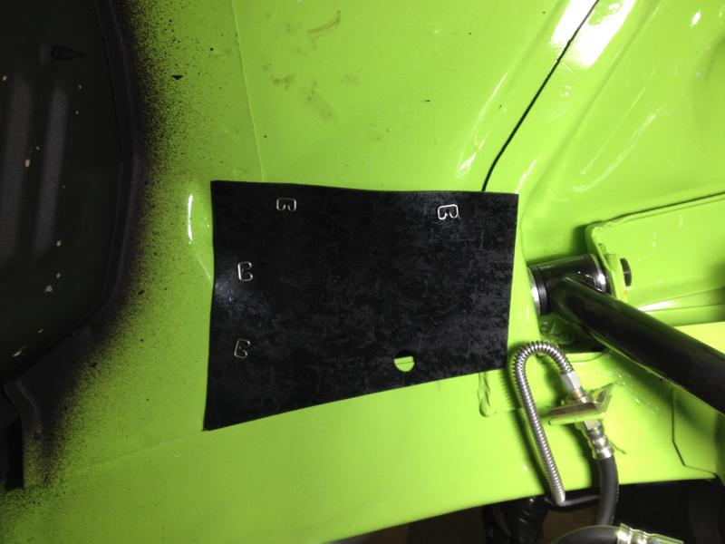

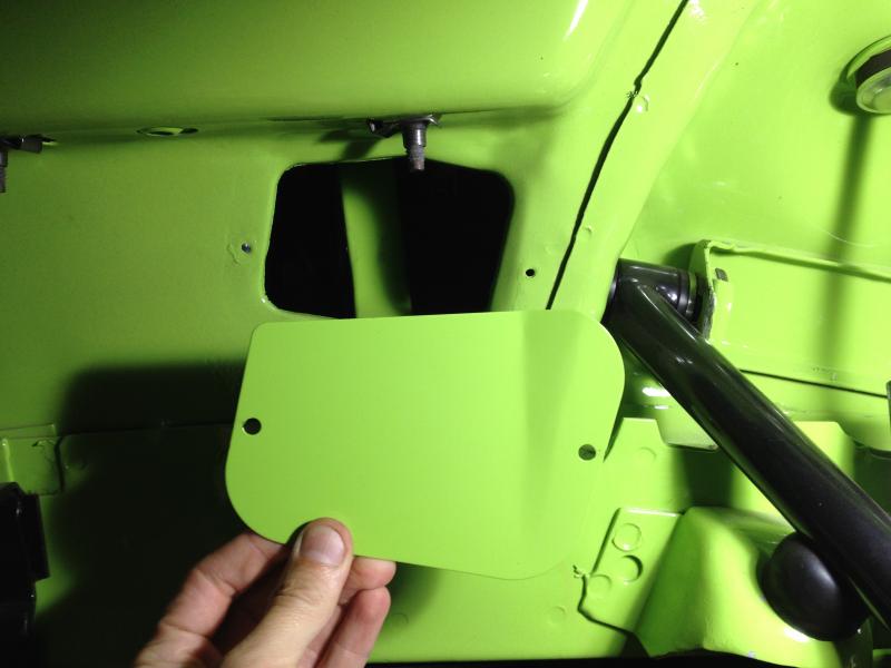

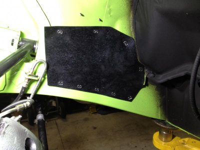

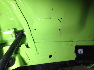

After I had the front wheels aligned, I installed the splash shields. Here I what they look like:

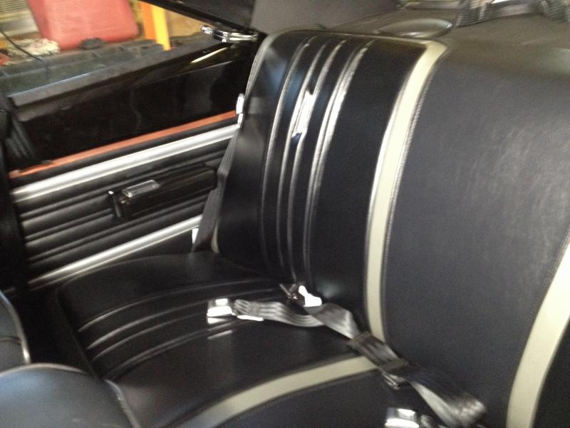

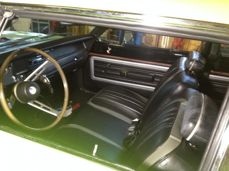

I now have the interior fully installed. I elected to reuse my existing door and panel trim. My car had fake wood grain on them, but to the best of my knowledge it is not correct for the car. However, I replicated that so I could further hide the seat belts in the rear of the car. The wood grain I received was not the ideal color, but I am out of time so I installed it. I am not in love with it but it will have to do for now. I think a later modification will be to put polished ones in the car. I think they will look better.
I just a couple of pictures of the interior. Not great pictures to be sure as they are a bit blurry, but hopefully you get the idea. Note the seat belts coming through the trim in the back seat picture.
The car is essentially done, although I still have some small tweaks to ensure everything functions well. For example, my A/C belt is squealing, so I need to align the compressor better and tighten the belt back up. I think with the belt setup and hidden location, this A/C compressor could be problematic. I think the belt and pulleys need to be set up perfectly for this to work well.
