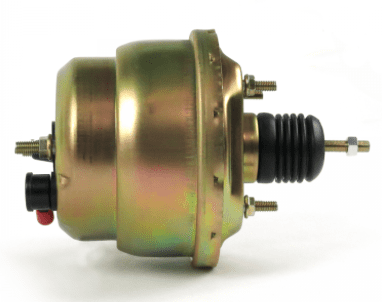

If it's this style....
It's probably bad... I had a customer with one like that, I replaced it, still no brakes, rechecked everything & convinced myself I must have gotten a second bad booster... Got a third... Still rock hard pedal... Triple checked everything, was talking to a friend who builds allot of hotrods for customers... He tells me he's replaced over twenty of them & refuses to do it anymore... He only uses rebuilt OE boosters.... I got an OE booster for my customers car, had Dewey rebuild it & the brakes were perfect.... I'll never waste my time on one of those again...

Is that the Chevy corvette type one that comes in all the kits??
Junk
