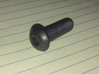

I need 5/16 x 18. 3/4" long would be ideal, but i can cut to length. Hex needs to be no more than 5/16" wrench size.
Just bought this bolt and will give it a try on lunch today... Not my first choice, but gotta start somewhere.

I have all those, but they won't work. It's not the access to the bolt that is the problem. Its room around the bolt to actually turn it. As soon as you slide the open end of a wrench onto the bolt and turn it, the jaws hit the tube of the header and push the wrench off the hex.

Get a reduced head (3/8") header bolt and put that sucker in first. My RB 1 7/8" header is the same way but I can get a small 3/8" wrench in there.

Yeah, that crossed my mind before. I had the same problem with the headers on a 440 in a class c motorhome. Considering how deformed the tube was from beating on it to get some clearance, i honestly don't think a a sleeve in the tube could **** up flow anymore than a tube being manhandled with a ball peen hammer....yep, a sleeve just large enough to accomodate the shank of a torx or allen.

As for the bolt itself, once you get the headman bolts in there you will be able to take 1/16 turns on it. Flipping the wrench each time. I also use a crows foot and an extension to torque it up with a torque wrench. Remflex headers are great and they only require 20ftlbs to torque correctly.

IMO The 12 pt heads are far better in tight areas
a lot more ways to get a 3/8th in. box wrench on them
ARP sells them like $18 5/16"-18 x 3/4 or 1" with 12 pt head
in either black oxidized {prone to rust} or stainless steel
that's if;
if you can get into the area enough, to get the box wrench over it
if you need to use crows feet etc. you'll need to go with
the six point/hex head design
in a 3/8's head for some added clearances
