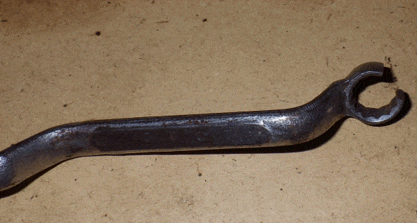

Just glanced through the replies, but the custom made tool is your answer. I've made a few over the years. In this case, I've ground the tips and contour of an open end wrench just enough to turn the bolt head.
The issue with a box end is that there's no clearance between the bolt head and header tube to get the wrench over. Been there.
The one with the cut out is severely weakened, but may work.
There are new open 12 point ratcheting wrenches, but I bet they're too big as well.
