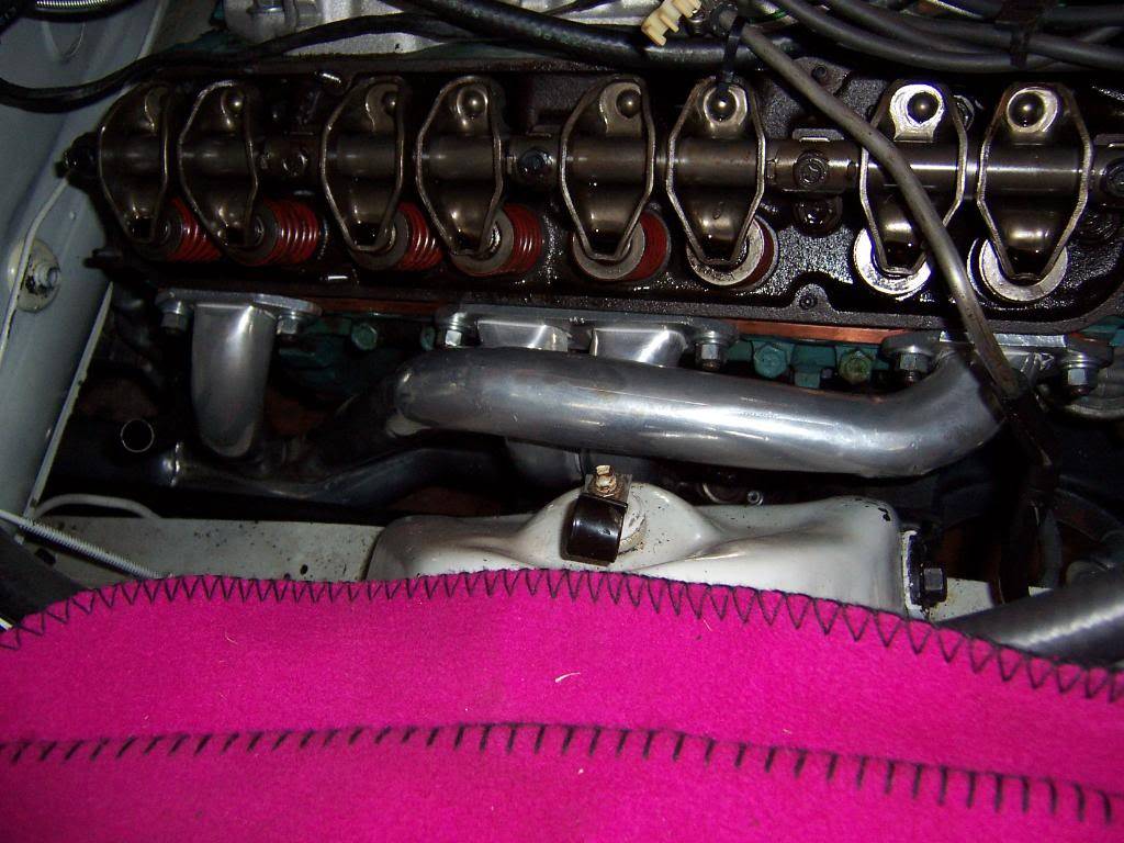

May I offer a bit of advice here? Having just experienced the joy of putting pipes on the '64/RB combo,I can say this: You may not be able to get a bolt behind the pipes on cylinders #1&2. I left my original studs in and just used new nuts. A lot depends on the design of your headers. If you can get a bolt through there and want to use bolts,make sure you use sealer on the threads,as a couple of them go into the water jacket(at least on b/RB mills).

The B-body header design makes a dramatic turn after the port,as you can see:
I'll agree with Al. I have never used bolts on my big block headers. In some cases you will have to start the nut with the header flange slightly off the ports. Also the studs make it easier to install and retain the gaskets while you bolt things up.
