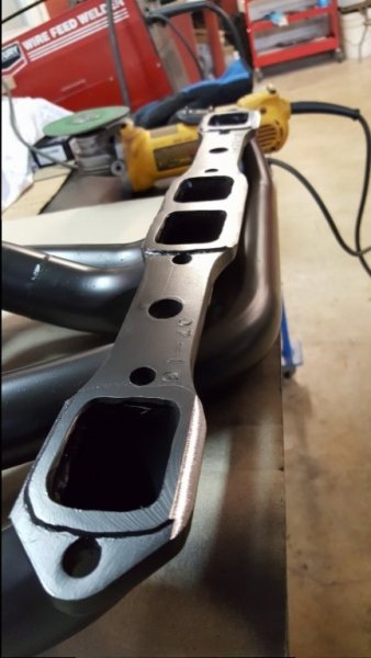

Another note when using Doug's headers on 452 heads is that these heads have a ridge that won't let the header flange sit flat. I don't know if other heads have this or not.
Had to grind a bevel on the flange for it to fit flat.
