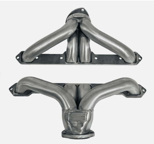

I am not a fan of the shorty's. I haven't had much luck from the bottom on a bb. But I have not owned every header either. Sometimes...I have had to lay the starter in the header and put them in at the same time. Summit has a good search engine..go there and these will pop up along with a bunch more. Nothing really that others have not already posted.Lol

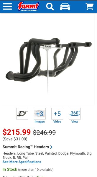

1. cheapest coated headers.
2.cheapest available from summit(someone else likely makes it)
3. 1 7/8 hookers
4. 2nd cheapest.
Hedmans are also available..I did not look for them
I have the opportunity to buy those hookers #5903 at a good price, but I'm not convinced they'll just drop in, or install from the bottom on my car???
