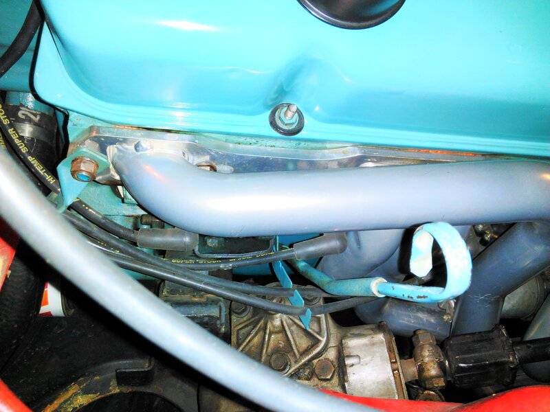

I just installed 2 inch primary TTI's in my 65 Belvedere 440 Auto. Easy install, good fitment. However... toughest Plug change I ever had with any RB headers, and also requires good heat shields over some off the plug boots. Very challenging on passenger side.

2 inch????......i have 1 7/8 OD....no prob with plugs...lot of room
