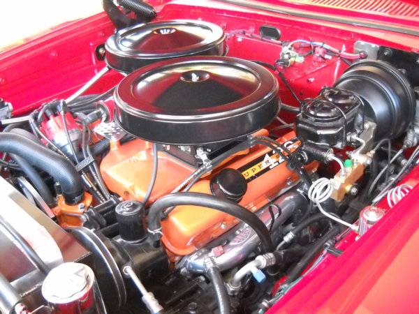

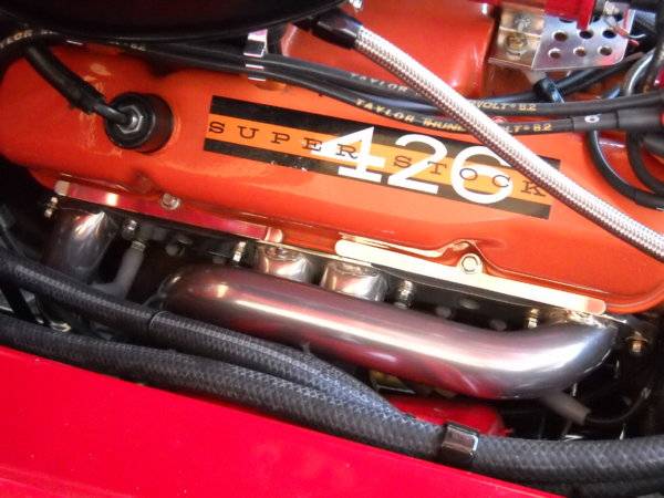

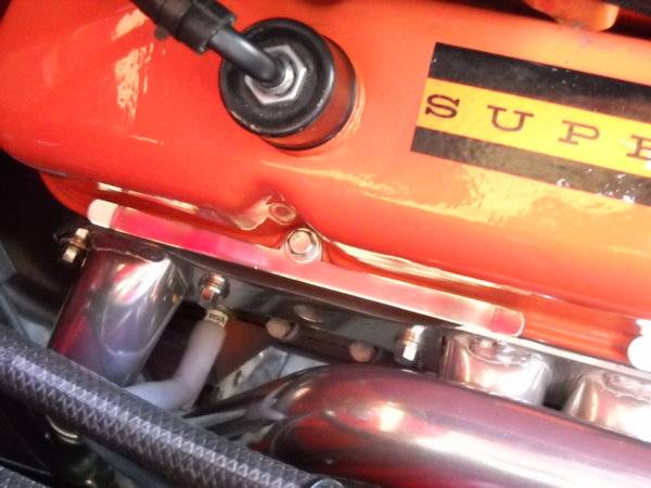

I have 2" TTIs in my Charger with a 440/493. The spark plug clearance is decent. The pipes clear everything. I've had them since 2006. No rusting, no warping.
