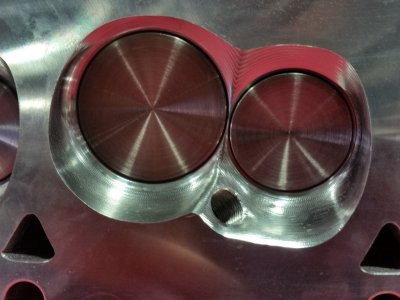

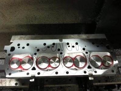

here are two shots of the bottoms of my heads on 2 projects. the first is the 58 cc Trickflow head for my 302 ford. the other is the 440 source stealth head.
i bought my Stealth heads bare, and had them CNCed and build to match my other components. the Trick flows were ready to go out of the box, they were perfectly flat, the Stealths heads are wavey as hell, and the Trick Flow combustion chambers are better.
to build the Stealth heads were around the same money than if i would have bought the 440 trickflows off the shelf. and i think the trick flows are better in almost every way... should have waited!

Thanks for your review of the heads your using. We could use a section for this forum.

The man above said the Trick Flo head was good to go out of the box.

There isn't a head on the market that shouldn't be taken down and inspected, even the new Trick Flow heads. I've had seven of the Trick Flow heads in the shop. Every one has needed some valve guide work and they all have some aluminum bits inside the ports and have needed to be cleaned and reassembled.
