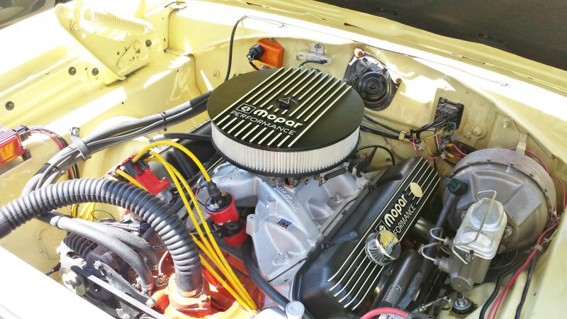

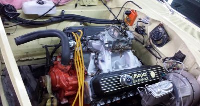

Has anyone ever installed a set of Heddman Elite Headers on a 440 motor with Aluminum Stealth Heads from 440 Source in a 68-69 Bbody?
I guess my main question is...is it at all possible to still get those into position once the motor is already in the car or is it a case of having to lay them on the inner fenders while the motor is being lowered into the engine compartment and then having multiple helpers guide them into the right place simultaneously?
The car is a 69 Road Runner with a stock k-frame, factory sway bar, a 727AT and power steering.
The car is almost done after a long restoration and I'm ready to drop the motor in but I didn't want to do that and then find out that I now couldn't get the headers in place. Everything "looks" like it's gonna work but I'd prefer to not have to do the job twice if I can avoid it. Just lemme know if there's a particular order I have to follow or not. Thanks!

stock suspension you will have to lay them on the inner fenders while lowering motor in or lift the motor on each side once it is in then slide headers up from underneath, if you have aftermarket k member like a magnumforce, you can slide them up from underneath.
headers on a b body with a 400 is a really crappy job.
Have fun
I put Hedman elites on my 440 but I did not have power steering, we had no trouble getting them in but I did have to cut into my bell housing on the right side to make them fit right, I also had to return my MSD mini starter because the solenoid was more of an issue than the stock starter.
