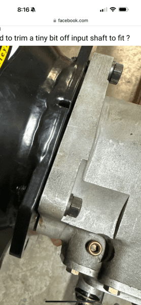

And then Transmission wont bolt up to bh .
Look at input shaft on 855
Measured hellcat crank pilot hole
Asked everyone on FB if quicktime BH has discrepancies.. noone knows .
Measured 833 shaft
Looked at other drilled cranks .
Everything looked close +- .050
Pull trans out again and trimmed input shaft
Finally it slid in nicely.

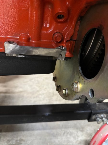

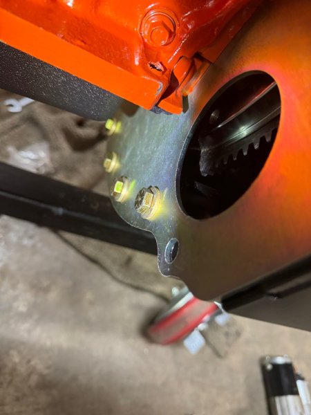

Then I tried to put starter in .
It wont fit .
Hellcat swap on FB said all you need to do is trim/ grind a little bit ..
yeh right ..
Im still chewing on steel powder .

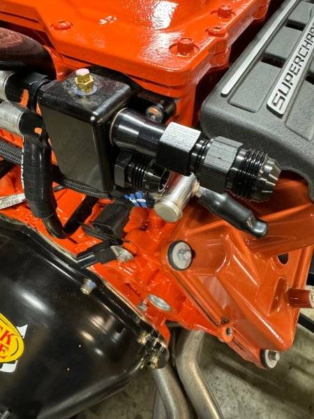

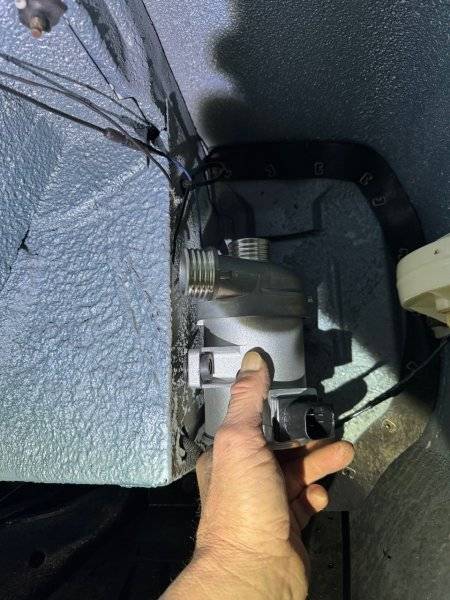

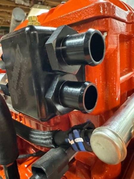

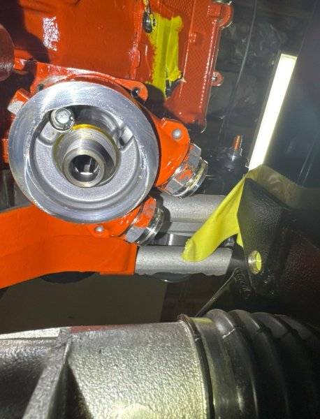

I looked at my oil filter and realized that with the hellcat oil cooler housing is touching the rack - crap.
Move two cars,
Get the engine lift back into heated area and lift the engine again.
Pulled the housing off the engine
Now I cannot cool the oil the stock way.
So I ordered a new nipple and guess i cant drive the car in Arizona for 6 hours straight.
Does Anyone have a recipe on how to do these swaps correctly the first time around ? Lol
I was also shocked at how much grinding was necessary to fit the starter on my 6.4. A picture like yours would have gone a long way to setting expectations.
There might be another starter out there that requires less grinding - But I wanted to make sure any starter would fit -
The 2015 Ram starter with man trans might have larger diameter than the super expensive aftermarket ones.

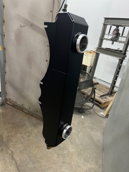

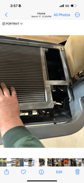

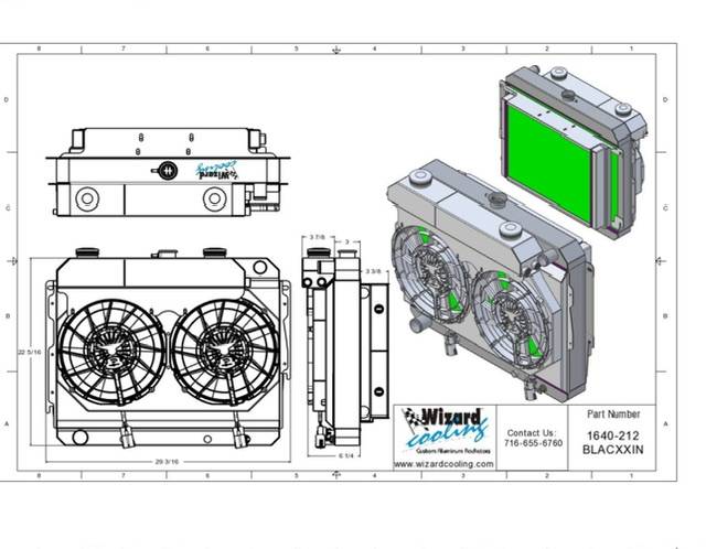

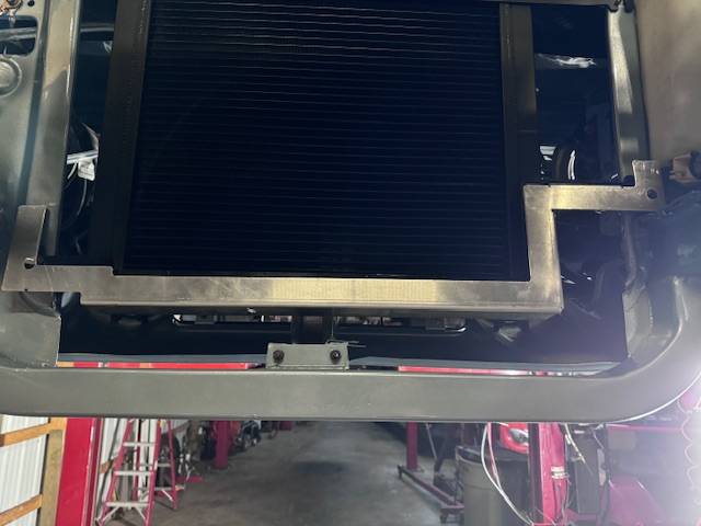

Modified Mounting for Radiator - finally with help from one of my buddies at a cnc shop
Didnt realize i didnt post since January
I dont know where to start
Every time I tried to move forward -3 steps back
Lol .

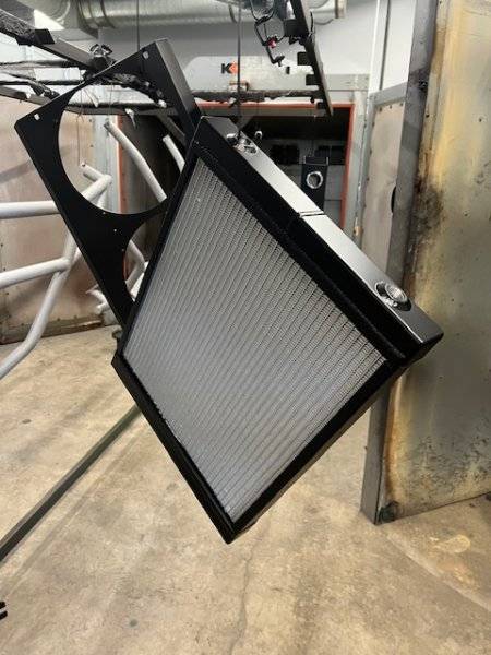

Got the Lizard Radiator powdercoated finally

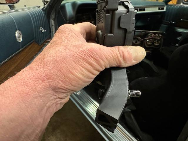

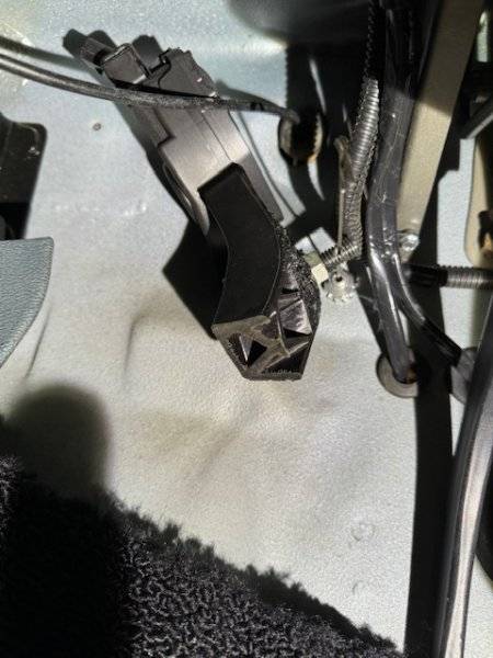

Spent a couple weekends trying to figure out a cool way to use factory 71 gas pedal and cable .
I Cut the wired pedal , mounted on inside firewall and rigged a method for accelerator pedal to position Hellcat pedal .

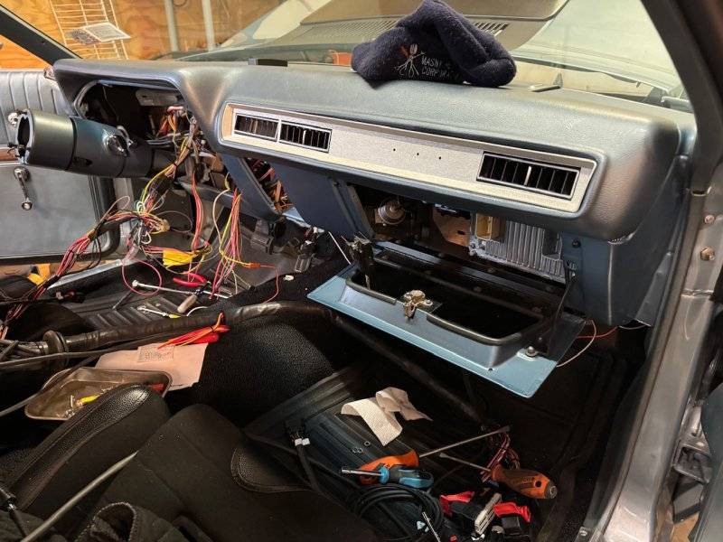

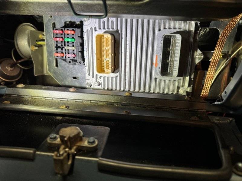

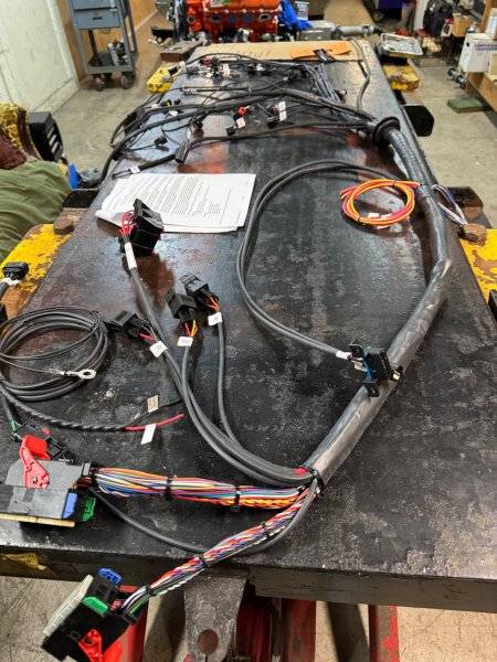

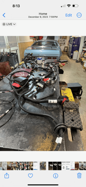

The hotwire wiring kit is awesome
Everything fit like a dream
Side by side comparison- mopar harness vs hotwire harness .
Every plug fit perfectly!
Cant believe the details necessary for this .

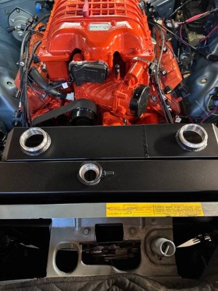

Im close to completing..
If course wiper motor didnt clear szwartz manifolds
had to ditch the nice nos motor with a chinese 2 speed and change linkage
Got most of my plumbing figured out
used as much silicone hoses as I could
I think that was a mistake. Need an ugly gear clamp
to really make them seat nicely.
Pressure testing made me replace most of the fancy
clamps I purchased.
