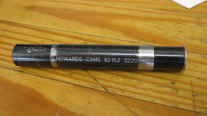

Don't buy Howards either! Get NOS or good used if you need a new one.
