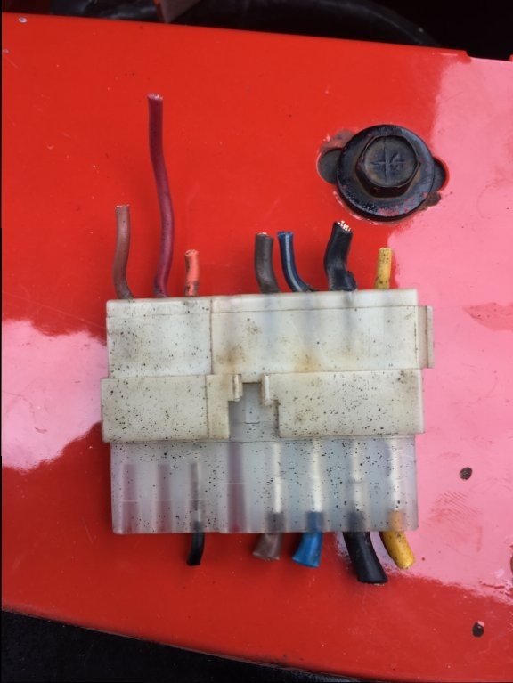

So just to update y'all...
I purchased a new ignition switch, the car started so I backed it out of my garage got under the dash looking for the wiring for the switch so I could test it with the new one first by just plugging the new one in outside the steering column. I found the plug as I started to move it the car died and would not start. Wiggled it some and started back up wiggled While it running again and died again. So I removed the plug and spliced the wiring together and the issue is gone. Thanks for all y'alls help!
Why did you not just fix the bad connection or splice only the one or two needed
Or have you ordered a new harness to fix properly
