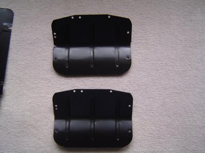

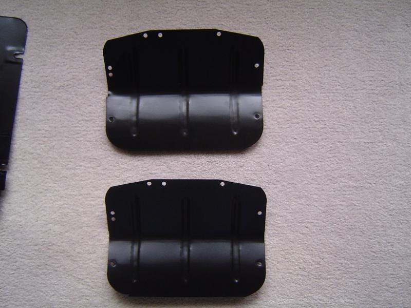

. Question- what sort of inspection cover went over that hole in the inner fender panel? is it rubber, metal.
They are metal, I saw a couple of sets on ebay yesterday while searching under 73 Plymouth, pretty cheap if you need a set.
They look like this
