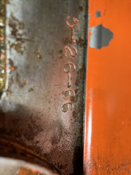

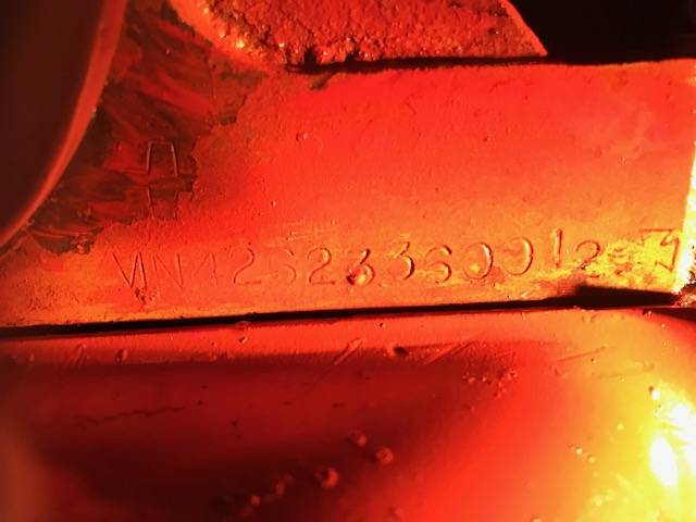

My engine does not have a vin on either location.
simply the date on the raised pad below the coil. Which is where all 1966 and I think 67 engines as well
66 application will be BH ( same as mine )

Those pics of vins I posted are of engine Ive grabbed off the net.
OK - misunderstood the photo with a VIN.
