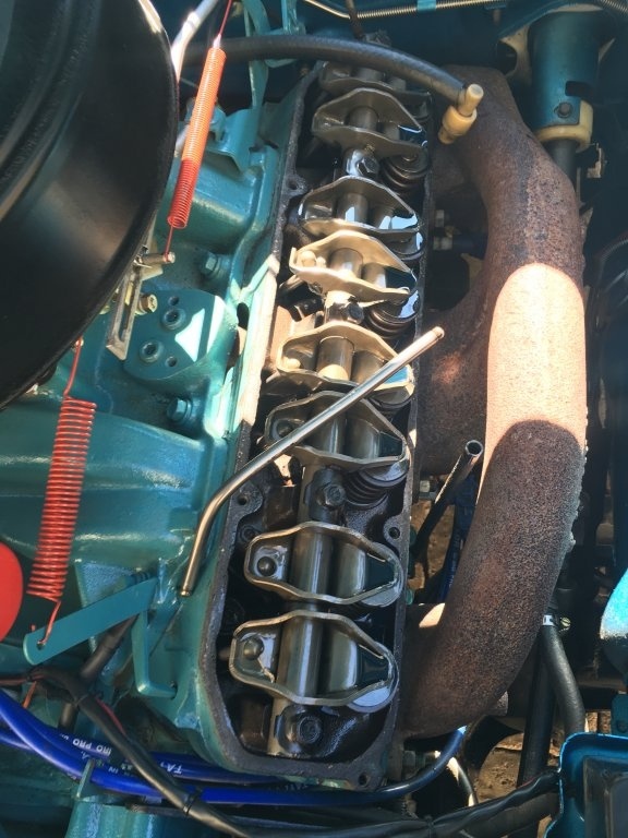

I don't know anything about the engine except the first problem was that the drivers side rocker shaft was put in upside down, we all know what that does. Had the rockers, shafts replaced with a high quality set, thought I was good to go...... not so fast.
Next day huge knocking sound, same side, loss of full power....then this

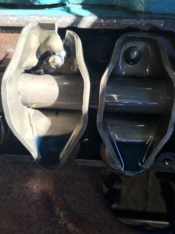

Two broken rockers, two bent rods. Notice that the bent rods are beside the broken rockers?
Help.....PLEASE

I have to agree with what many have said so far, first the machine is beautiful, and second, hang in there. When buying anything that's nearly 50 years old it's probably had many hands upon it, not all of them knowledgeable, these kind of issues go with the territory. The first thing I would do is get a bore scope in the spark plug holes on the cylinders with the bent push rods. I would suspect valve to piston contact. Not trying to scare you, but this is the most likely cause of that type of breakage. I have had improperly sized guides on a brand new heads (Indy) cause valves to stick resulting in the very same thing. You need to check compression on those cylinders. If it's currently 0 you can be sure a couple of bent valves aren't seating. It's not as bad as it sounds, if you have forged pistons, they are pretty tough and have probably survived this incident. All is not lost, a slow and steady approach will get it sorted out.

Thanks for all of the support and advice, turned out everything down to the block was scored or cracked, even both heads had huge cracks that had been welded. On the positive side I am having a new 440 Stroker built by one of the best in the business.
