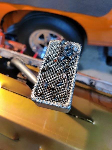

And ... I'm a little concerned about "debris passing". Have you investigated that at all ??
May be the time to post some pics.

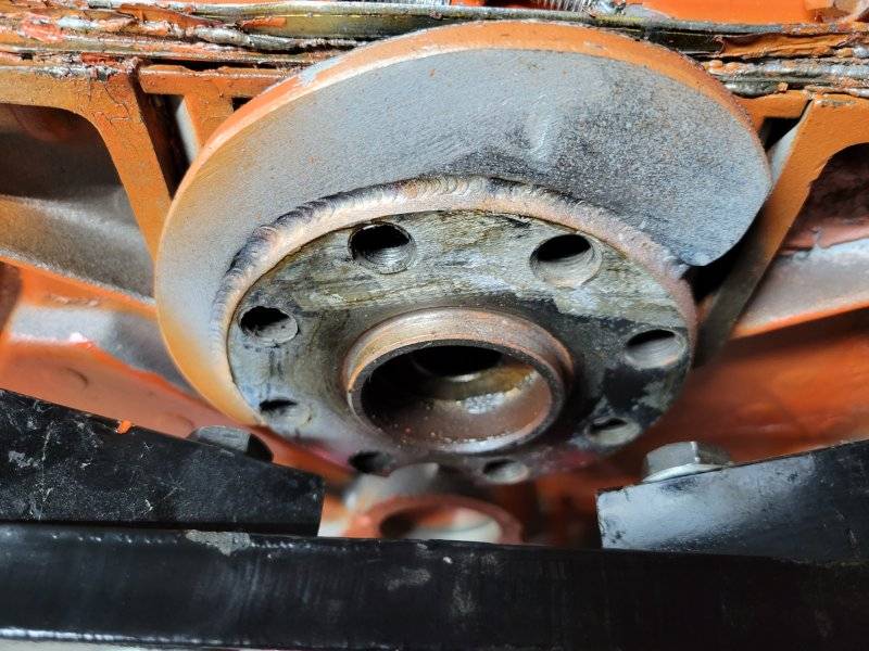

Yeah, it had 80 lbs of oil pressure the one time that I started it to move it, the rotors are just rough looking. I bought this car with a ladder bar torn off of the Dana. The guy was tired of spending money on it, or should I say his wife was. It's been a money pit, I thought that it was a restored old race car, it wasn't. That's on me for not looking closer. I just kept finding things, see pictures. Originally, I was just going to repaint the engine and oil pan, when I saw the oil pick up and the crazy balancing, decided to tear it down. It's got H-beam rods in it now , over 4 lbs difference, rebalanced. I'm just trying to straighten out a few little things. The block is at 70 over, it's had a rough life, plus battle scars. Wheel weight lead was found under the Mallory slugs. I will get the HV pump. She will clean up and do what I want her to do, till I decide to get a new block.

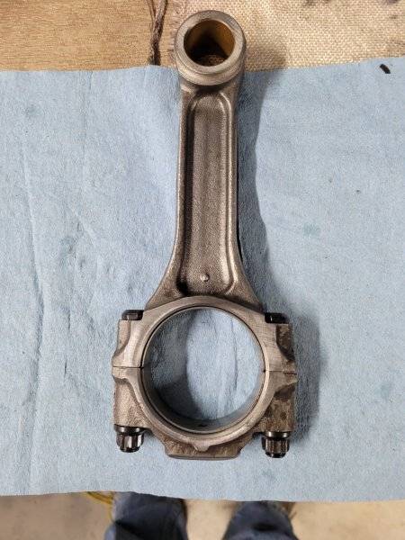

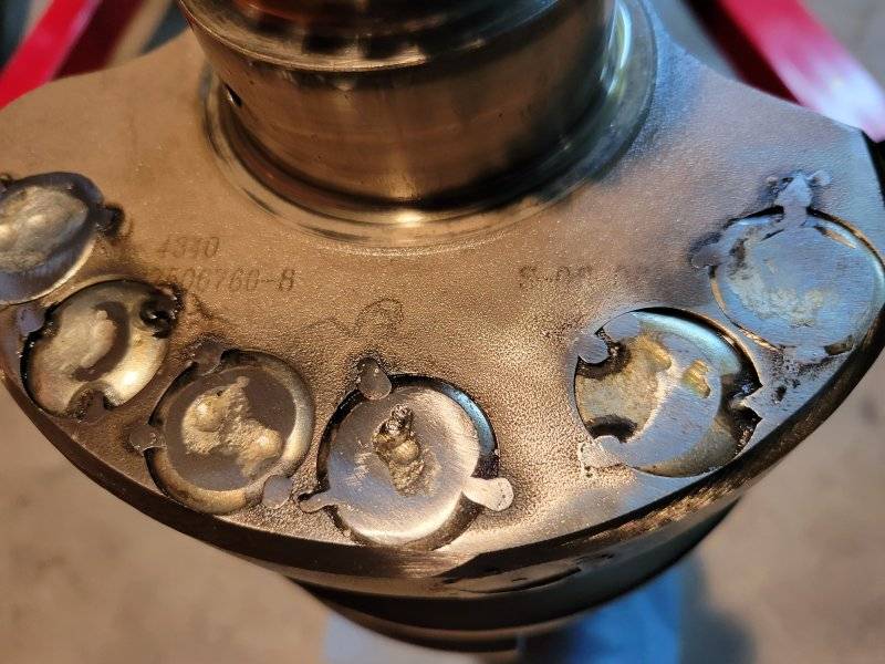

I don't know, never saw that before. Took over 4 lbs out with different rods. Picture of the rod that I took out. Crank is a stock stroke, 4340 Eagle. Not my first choice, but it'll work.
Yes, ordered a HV pump from Summit.
Cant imagine why that much weight would need to be added to the crank. Where did the debre that went through the pump come from if you know?

From just what I see of the crank I would conclude the rest of the motor to be a piece of ****. The first thought is someone took a bunch of junk rods and pistons to the balancer and said "do what it takes" to balance it. And you're seeing the end result. What other possible reason would there be for a ton of weight crudely welded into one throw and a humongous turd welded to the flywheel flange ?!?!?

Wow. Never saw anything like that but then again in these days nothing seems to surprise me...

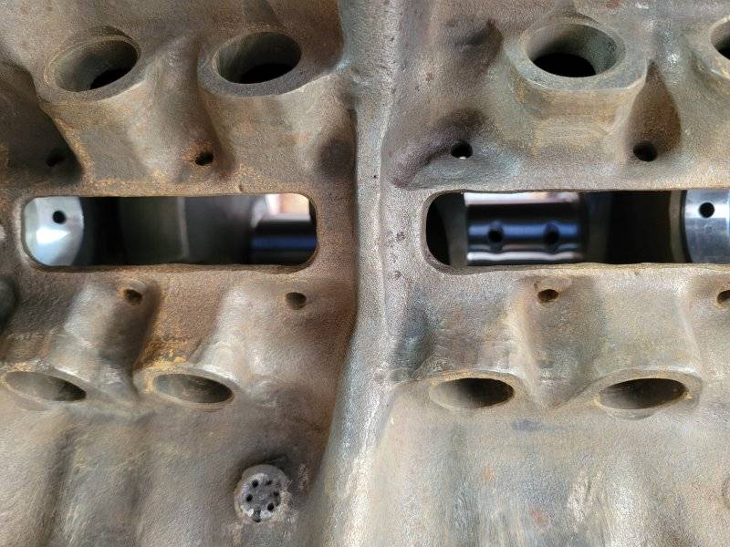

I don't think it will ever run over 6000. I have a new stock oil pump and HV on order. It has an 8 qt pan. Looks like someone drilled these in the valley.
The issue is oil drainback from the heads, not the lifter valley.
If you aren’t going to race the car, you shouldn’t have any issues with an HV pump.
