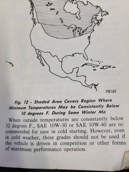

I did just replace the standard pump with a HV. That bumped my hot idle pressure up to 22 from 17, which was my main concern when this experimenting started. I know a lot of guys are running 20 psi at idle and are fine with that.
Since I ordered the 10w-40 from Summit instead of Amazon, I am not going to return it. Personally am curious as to what difference the hot idle and cruise pressures going from 10w-30 to 10w-40. Like I said before, this shop recommends 20w-50 Driven in everything that goes out their door. Right or wrong, I have no clue.
