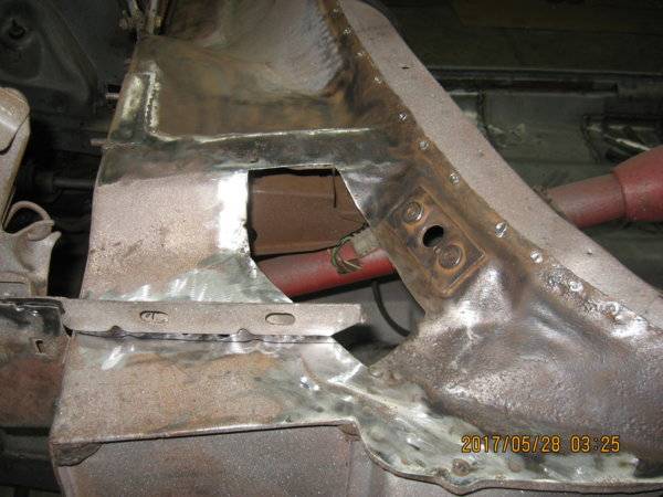

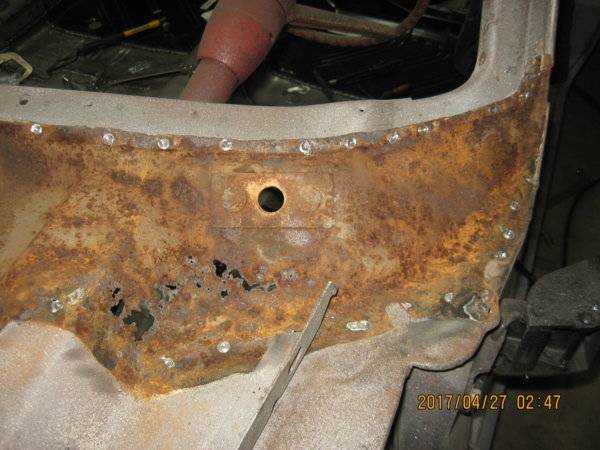

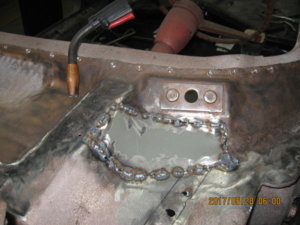

Deja vu! I went through this a couple of years ago on my 64 polara and had to learn to weld. It is tough trying to seal it up from below without cutting out and replacing the decaying metal. You can't really find all of the pinholes until you take a wirewheel to it. Maybe the guys in the shop can teach you after hours?
I'm going through this now with my '64 Polara convertible. Bit the bullet though and removed the outer cowl panel in order to fix the rot under it. This is where your water is coming from when it hits your feet during those rainstorms you mentioned. Your floor pans will hold the water down there too because of the carpet, so be prepared to have to do major 'surgery' there at some point unless you can stop the water from coming through the cowl.
IMHO, the only way to really fix a water problem like this is to cut out the rot and weld new metal in. Then take appropriate steps to protect that new metal.
