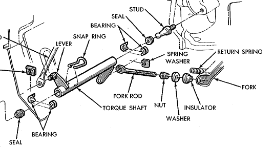

He also repeated what we already know - that the small spring down on the
clutch fork right next to the adjustment rod is what keeps the throwout bearing
off the fingers of the pressure plate and as long as that is present in place,
there's no worries of the linkage/pedal prematurely wearing clutch components.
