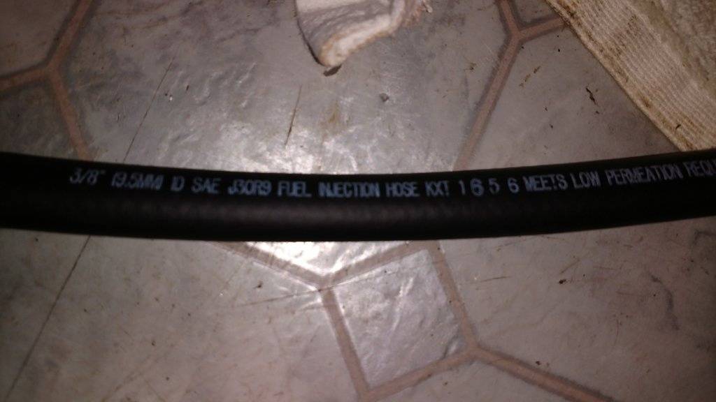

Picked up some today. $8 a foot!
I'm going to replace the small piece at the tank and the one from the front frame rail hard line to the pump.

Anyone know what makes this hose so special ? At $8 per foot, it must have gold in it. I have heard that silicone hose is resistant to todays fuel and that it stays flexible. . I don't know if it is made in the smaller diameters such as 5/16 and 3/8........................MO

It's the Advance Auto house brand, whatever that is; I bought what they had left on the reel, about 6 feet of it.
It appears that "fuel injection" hose has to meet this SAE J30R9 standard, which appears to mean that it "had to show fuel permeation below 15 grams per meter squared during a 24-hour test under SAE 1737 test procedures.
Designed for temperatures ranging from -29°F to 275°F (302°F intermittent) with a burst pressure rating of 900 psi. This hose handles E-85, diesel, bio-diesel and extended gasoline, resisting sour gas oxidation."

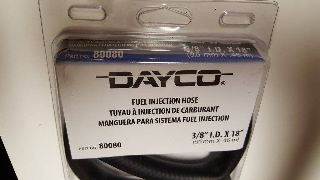

Sounds like the same type of hose as the Dayco.

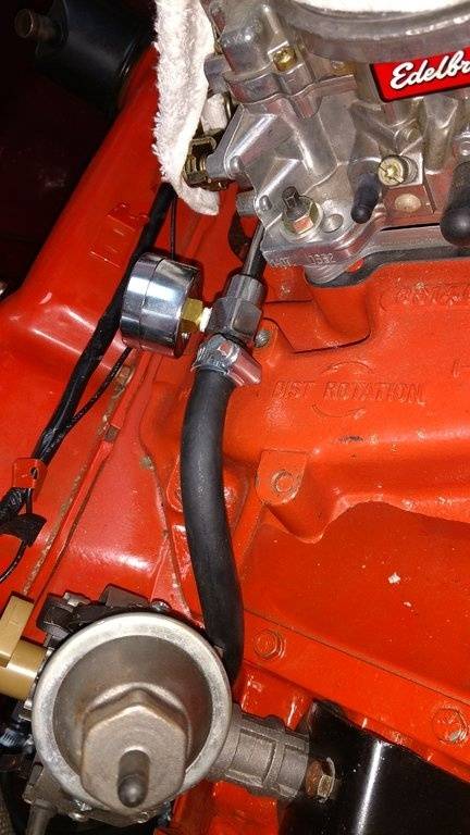

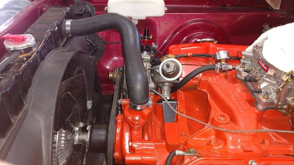

Recent monsoons just added to the work keeping me from the GTX, but hell-bent for leather anyways, here we go:
Getting creative with that $8 a foot fuel line...

Motor is looking good! Won't be long till it fires up.
