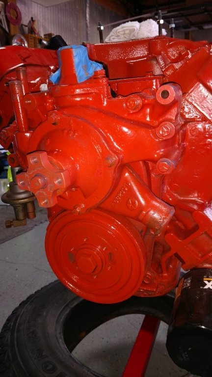

My (probably now infamous) '68 GTX has started undergoing yet another engine swap
after all sorts of attempts to diagnose and repair the "mystery motor" 440 it came with when I bought it.
Given my present health situation, this will be the last time I ever do this.
It is what it is.
I hope everyone will sort of follow along and keep an eye on me as I try to do this mostly alone. :)

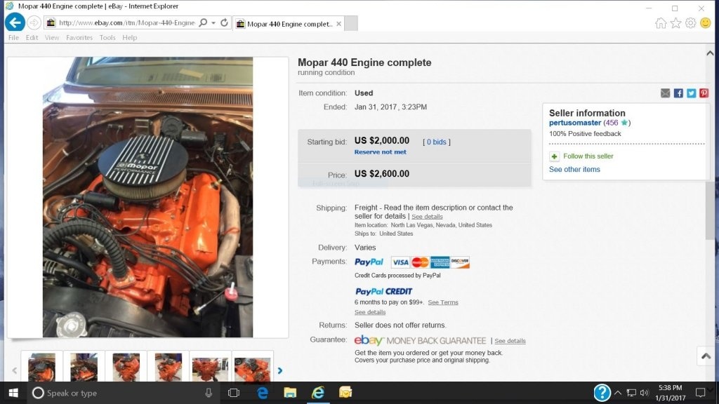

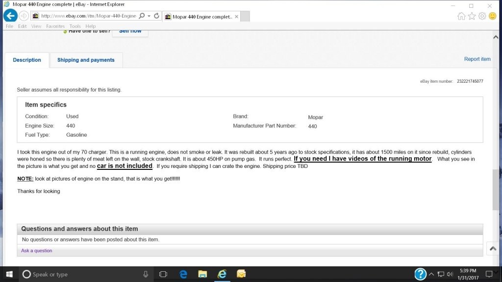

First off, I bought an engine from a gentleman out in Las Vegas. This was his eBay ad:
I just happened upon it right after he first put it up and immediately contacted him requesting video of it running. He graciously provided same:
Sounded good to me, so the deal was struck immediately and he took it down off eBay - even though I reminded him that if he left the auction alone, he'd surely get more than what we agreed on.
He'd hear none of it; we had a good long talk and he was happy it was going to a good home.

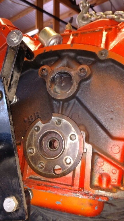

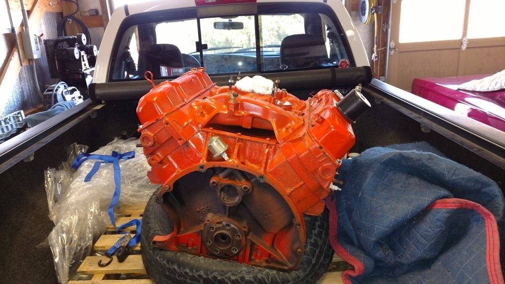

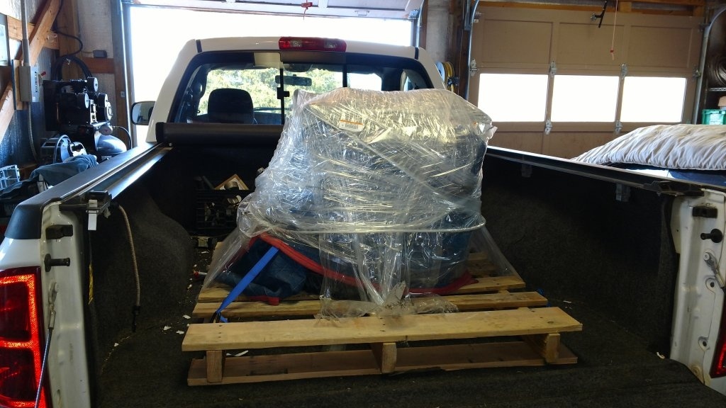

A week later, it arrived:
View attachment 395788 View attachment 395789 View attachment 395790 View attachment 395791 View attachment 395792
Looked perfect, no damage. Dang engine stand drooped under its' weight. :)
There was no turning back now...
