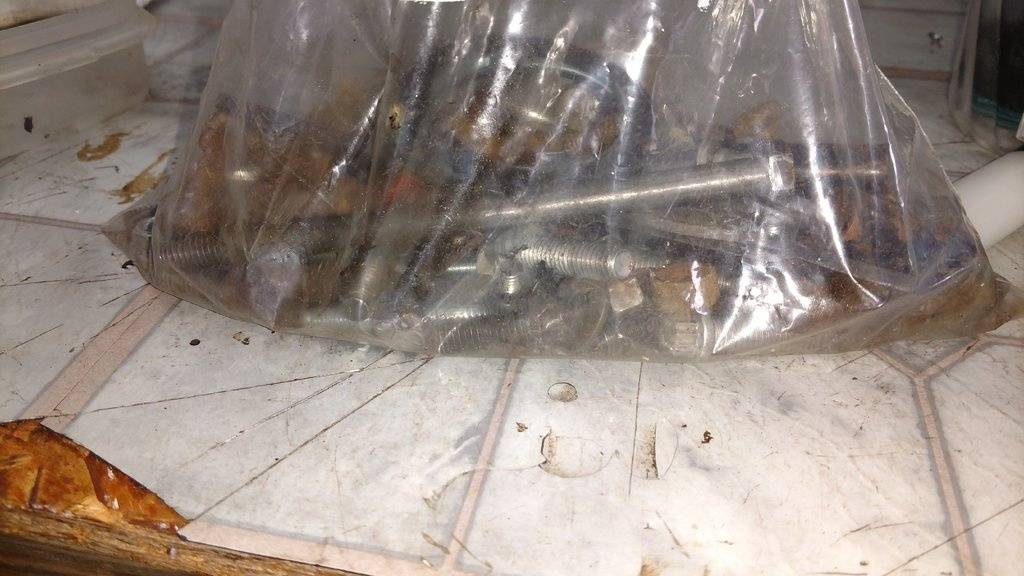

Cleaned up/uncovered my workbench, put stuff away. Tons of parts/fasteners left over:
That's good, right?
