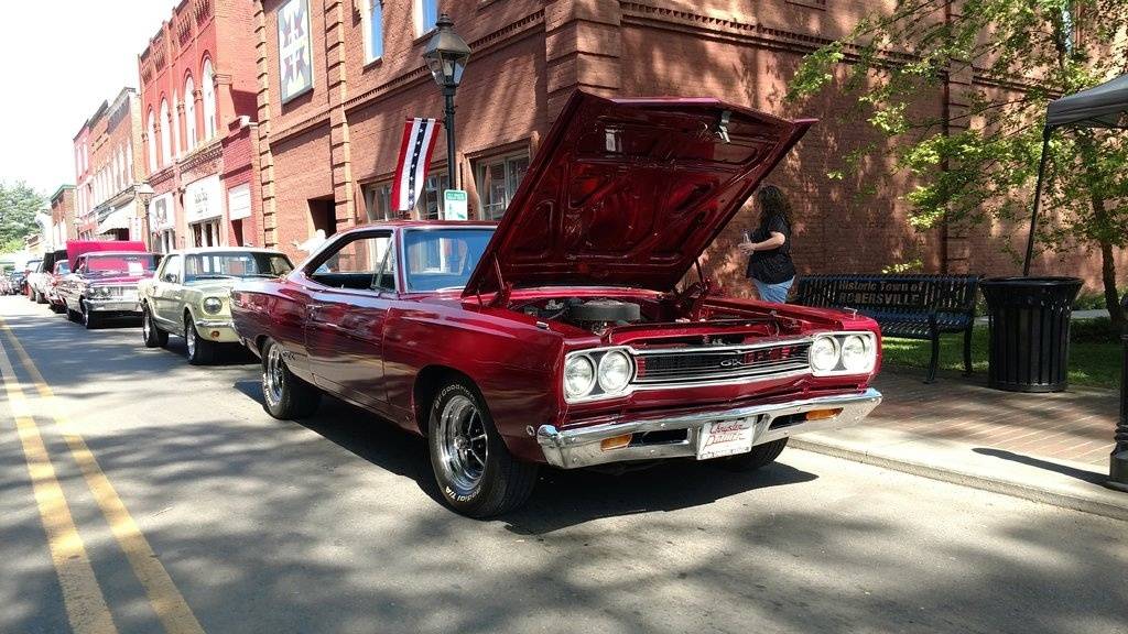

In the meantime, a friend came over this evening and we got the hood back on the GTX. Once that was done, I fired it up and went to pull her up into the garage a little more (it was all the way back towards the garage door for maximum working space in front of her) - and that clutch!
Holy crap, hair trigger isn't the word for it. The thing takes next to zero effort and it's a toggle switch, pretty much. Chirped the tires pretty hard without meaning to. :)
I found out you don't so much depress it "normally" with leg swing - at least for now, it's easiest for me to plant my left foots' heel on the carpet and just flex my foot forward and back on the pedal.
Kinda kooky.

Party's just starting. Haven't even had her out for a drive yet. Weather has been downright soggy for days now - but the first cruise-in of the season is this Friday and the weather is supposed to be pretty that day.
We'll be there.
We made it :)
Due to crap weather all week, this was also the first test drive.
More on that, but suffice to say I'm happy.
Verdict after a 12 mile round trip (including a few hours sitting on Main Street, front and center):
The clutch is truly bizarre. :)
If you're used to the old school 3000 pound long-throw clutches, this one will throw you for a loop. Literally a couple inches of travel is all it uses; it's dang near an on-off toggle. Made me actually concentrate.
Once I started getting used to it, I was able to start modulating it some. I'm definitely raising it up off the floor more, though.
I think I'm going to like it. :)
The transmission was simply flawless. Tight, quiet and held all gears without help whether accelerating or decelerating. No grinding, no need to double clutch.
Couldn't ask for better. Even the shifting pattern was tighter with zero slop.
The engine sounds genuinely healthy and is deceptively quick - I caught it sneaking up over 70 a couple times in short order with just my big toe on the throttle.
I did not take it over 3500rpm tonight, being very cautious.
The Edelbrock needs some tuning, especially right off idle where there's a little stumble like the accelerator needs adjustment or something.
Once past initial tip-in, she pulls just fine and obviously isn't starving.
I have the vacuum advance hooked up to the distributor right now also, but she seems to not like it; she's a little jittery around 2500 rpm (seems like that happens to a lot of these Mopar electronic ignition setups for whatever reason).
Overall - very smooth, no leaks, no boil-overs, heck even the ridiculous exhaust on the thing isn't rattling.
I've been blessed with this outcome, absolutely. :)
