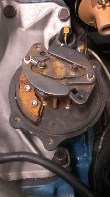

throttle cable looks fine to me. pulls and releases smoothly. nothing really to interfere with it as far as I can see. I checked the primaries and secondaries for binding and cannot fins any sigs of it. the electric choke seems to operate right. The carb is an edelbrock and I am fairly new to them, but reading the manual they seem to be easy to tune. I am wondering if one of the air bleeds may be clogged with dirt. It is a used carb. has anyone experienced any issues with a clogged air bleed on the carb? One other thing I found under my distributor. I found a lot of rust on all the parts under the distributor cap. could the advance springs possibly be causing this high idle?

Just wanted to keep all you updated after a lot of trial and tribulation... I figured out the high idle issue I was having. after taking all of your guys advice, I started wondering about the distributor and ended up taking off the cap and rotor, after the rotor came off, I immediately noticed one of the advance springs was missing. It was really missing but rather rusted off and hanging around in rust pieces in the distributor. I guess what was going on was one of the centrifugal advances was opening at start-up causing the high idle. I replaced the spring with a spare, and voala! Began idling nice and calm the way it should, although when trying to set the timing, besides getting the hell out of me shocked, my timing marks where acting sporadically jumping all over the place. I have an advance timing light, and when I moved the dial so the timing marks lined up at zero, my dial on timing light indicated zero degrees advanced at 2500 rpm. My guess is I have a bad timing light, so I will verify that next. Thanks to everyone for the advice on such a simple yet annoying issue!
