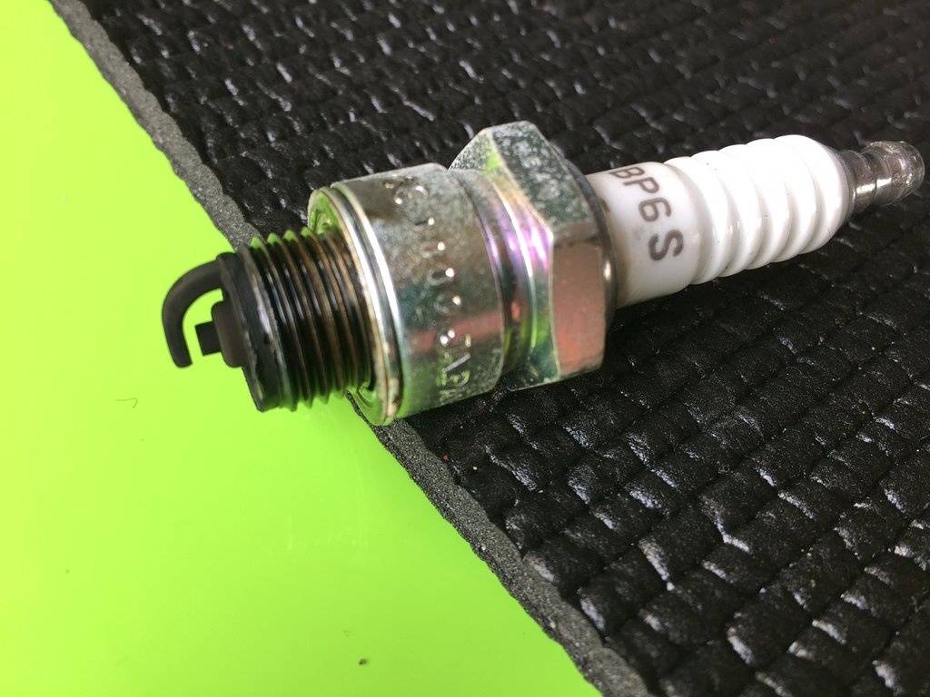

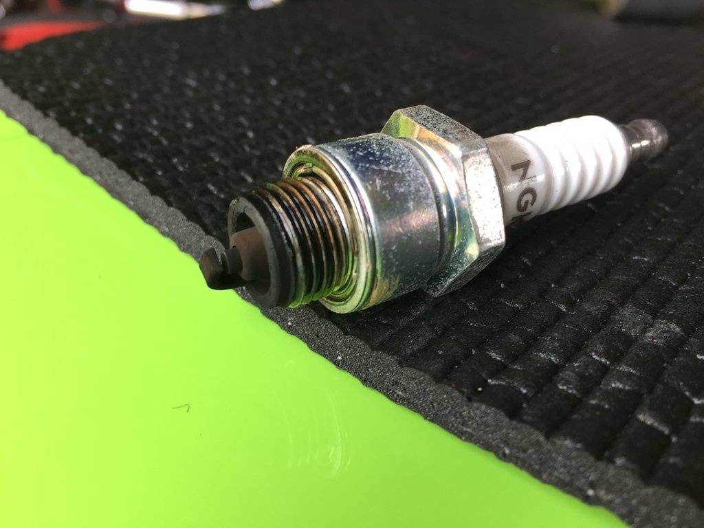

As a part of the troubleshooting i've decided to have a closer look at the spark plugs to see what story they tell.
As i keep having the engine stumble every now and then, knowing the fuel supply is good there might be more going on.
Spark plugs are NGK BP6 S, so heat rating 6 to me and as per stock should be a gap of 0.035".
I checked the gap and found most of them accepting a 0.030" feeler gauge, which makes sense as from what i read is that with higher powered engines the gap should be reduced.
Knowing the engine has been modified and puts out more power then stock i am wondering if this type of plug with that gap is a decent setup for this engine.
See the pictures of the average spark plug, the core is not fouled with carbon so it does burn clean and shows a quite reasonable color, on the outer ring there is fouling and some carbon build up but nothing major to me.
I've cleaned them all up/checked gap and reinstalled them, the random stumble at proper throttle remains.
Could there be some temperature issue that happens once the engine get high loads and the spark plugs start to get hot?
So once at higher operating temperature in the combustion chamber the spark plug fail to give a good/strong spark or something?

With all your fuel problems I would try a new set of plugs,maybe the same to start with. They look like ur running rich a little bit, might be from the bad fuel,sorry didn't go back to start of thread. At least a .035" gap on plugs, and idle mixture might be too rich at least from the pics. They should be almost tan/white on the insulator part. Might be too "cold" of a plug?
Not that it's your problem solver, but with the MSD ignition you should open the plug gap up to .045". And, I agree, the next hotter range of plugs or leaner mixture. Start with new plugs and do a resistance test on each plug wire. Look for (+-) 5,000 ohms per foot. Check the contacts on your rotor and distributor cap as well.
Good luck.
