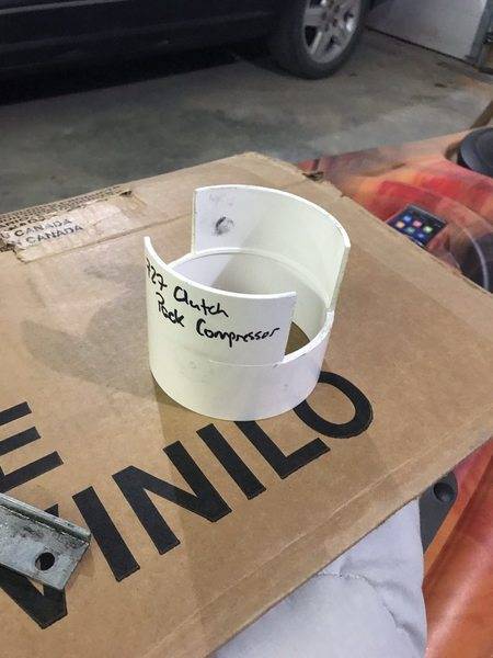

A few of mine...only one that would work on an older mopar.
727 Clutch pack compressor...
