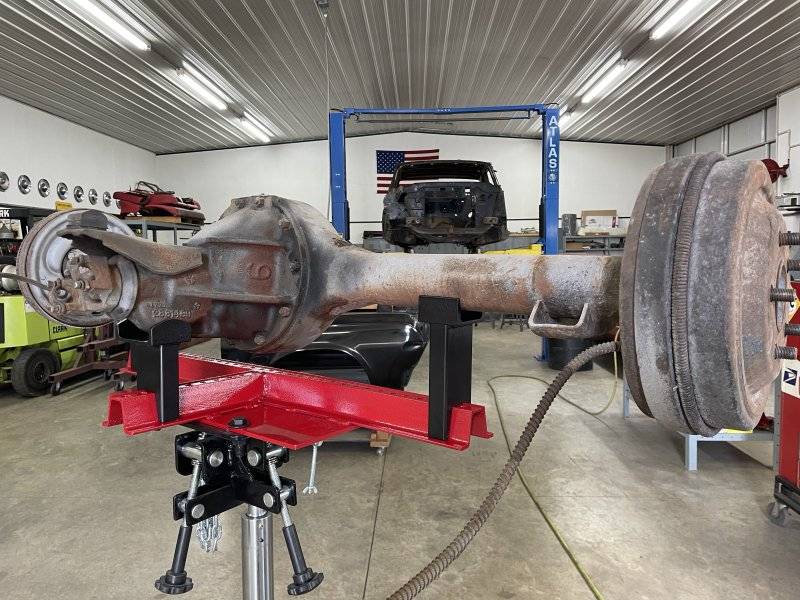

I bought myself a transmission jack for Christmas. My first job was to remove the rear end of the Savoy but needed something to make the axle more stable. So I came up with this fixture. Yes, that’s a piece of sign post the county donated after I found it laying out in the field a while back. Hey, it’s already got all the holes in it to make it adjustable, didn’t have to drill them in a piece of channel iron that was my original idea. It bolts to the top plate of the trans jack, works real well.
My trans jack is either to short or to tall. It may become an early summer rebuild.
