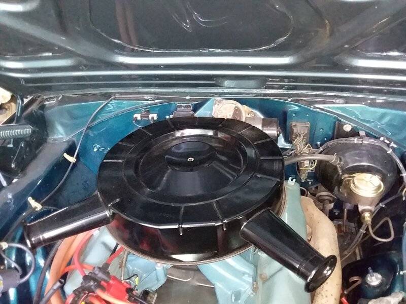

just installed torker on my 66 Belvedere 440, hood doesn't clear air cleaner which is from 67 c body, anyone know what dual snorkel will work?

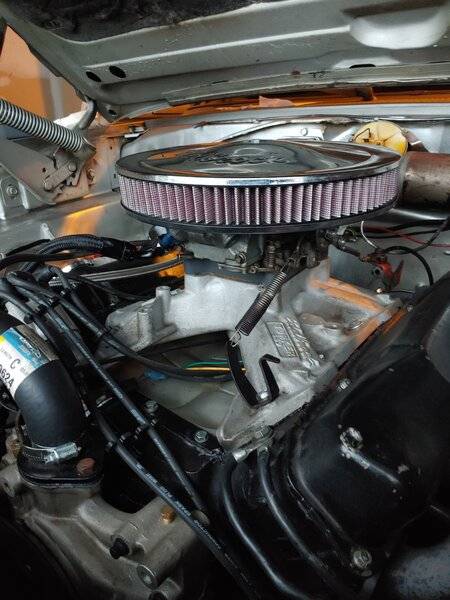

Mancini sells a drop base for 13” air cleaners which will buy you some room.
I know it's not what you were asking about but mines a 67 with 1/2 inch spacer and drop base torker intake
