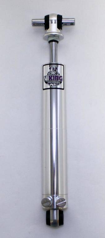

I am currently working on a mopar list for our new line of Vi-king Shocks if you are interested here are some of the features:
19 positions of compression and rebound
Lightweight twin tube aluminum construction with clear anodized
Wide range of adjustment from cruising to high performance
5/8 chrome plated piston rod
Aluminum precision machined piston with deflective disc technology and bronze piston seal

James...you should know better than to post a pic of "gm" shock on here, lol!!! You have me interested in what PST is gonna offer, keep us posted!!

Yeah I know but that is the only photo I have at his point lol. Just wanted to give you an idea. I am working on the spread sheet as we speak. I hope to have them up on the website early next week. I will keep you posted. I just put a set on my Malibu(I know, I know its not a Mopar but my duster will get them when it is ready for the road) and they have loads of adjustment.
