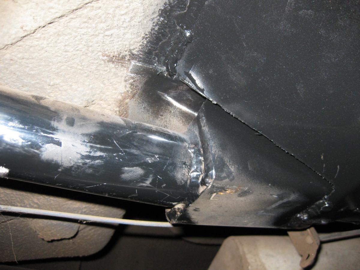

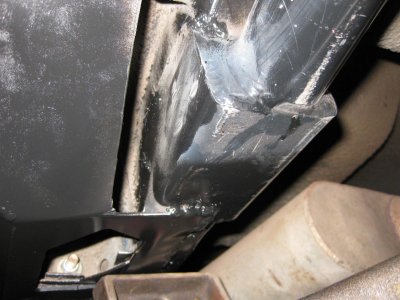

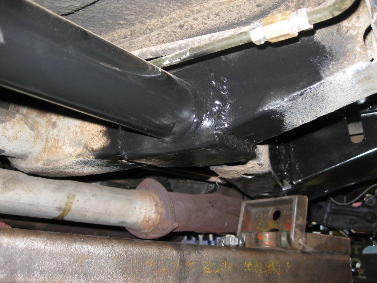

For subframe connectors I went with tubular from Global West. They're awesome looking and only weld in at the ends, which is better than bolt-in, which can become loose, but no welding required along the entire length of the floor, just a little dremel grinding at one location by the seat mount bolts.

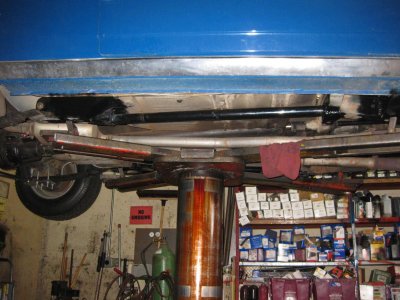

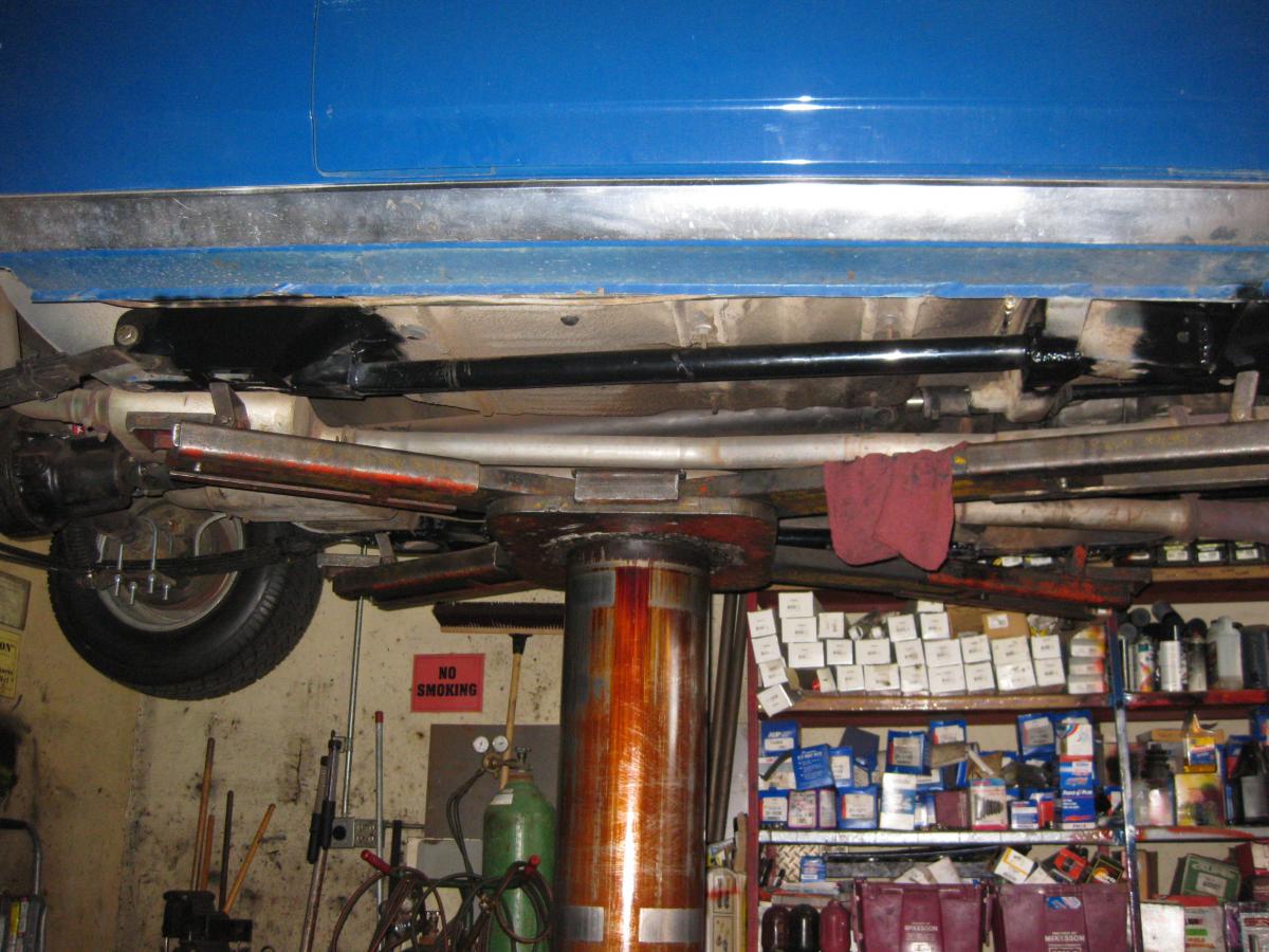

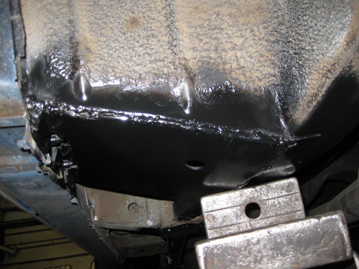

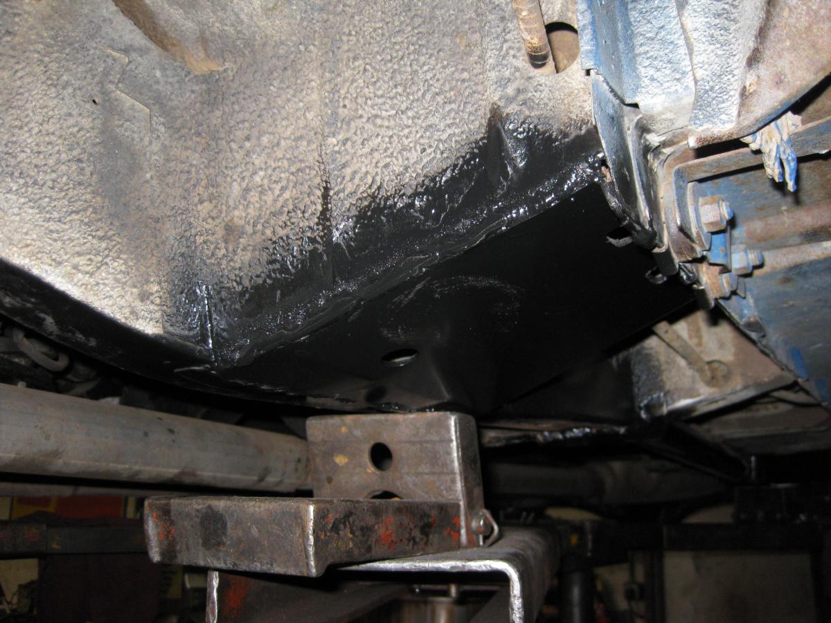

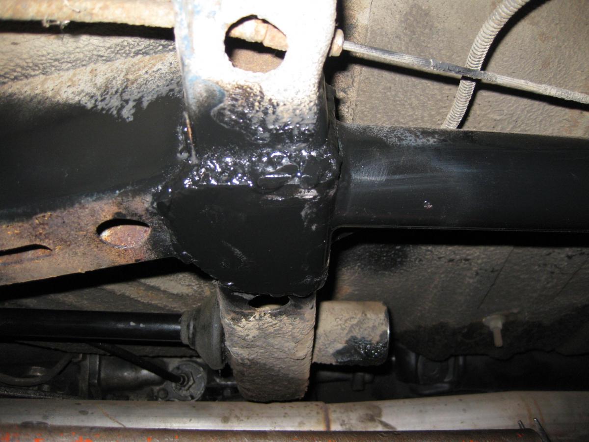

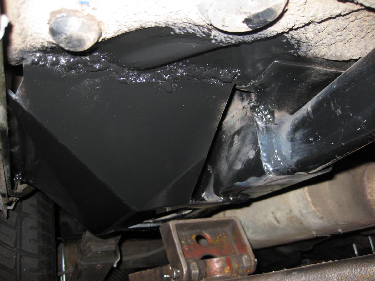

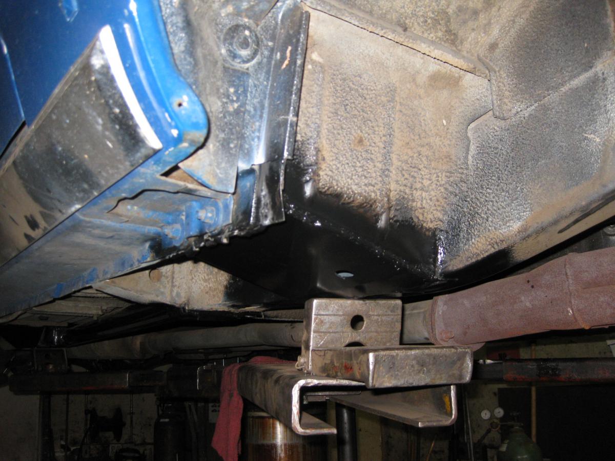

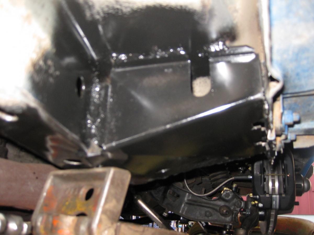

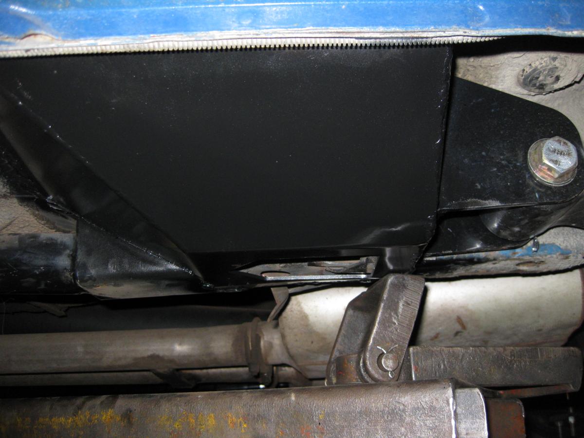

Here are the photos of my '68 Satellite with the tubular Subframe connectors I bought from Global West and the front and rear torque boxes I bought from Sheet Metal Stuff. I took all of it to a frame shop and they welded in the torque boxes around the perimeter seams and the tubular subframe connectors are welded in at each end. I can tell a noticeable difference when I'm sitting in the car driving that the car feels more solid and rigid. Can't feel the torque boxes, but they're supposed to protect your frame from twisting with high horsepower.
The subframe connectors were cheap! Only $155 / pair. I like these a lot because I only had to weld each end instead of along the entire floor and since they're tubular they give you more resistance against twisting and flexing than a square channel type connector.
The pre-made torque boxes from sheet metal stuff welded in with no issues from what my weld guy said. Real nice pieces and made to fit this car.
