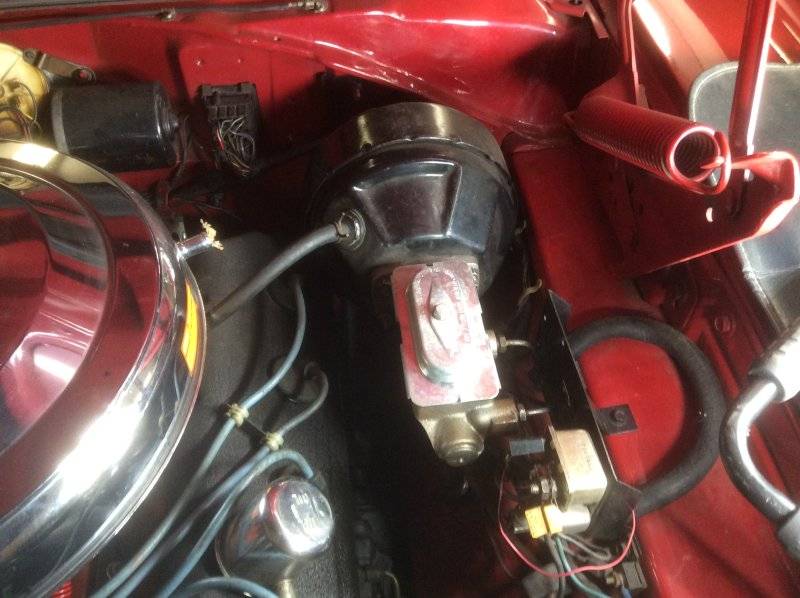

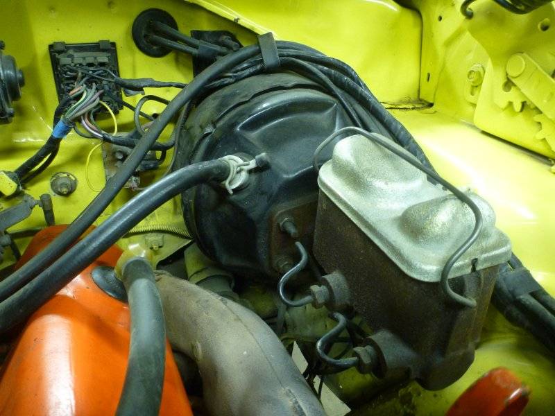

Dual master cylinder is a problem. Asked someone what year had passengers side brake outlets and I thought I remember. Forgot 68 or 69 maybe a RR that has passengers side outlets. Move one of the relays for clearance. Now if someone will tell me what year and modal has passengers side master outlets i will bookmark it.

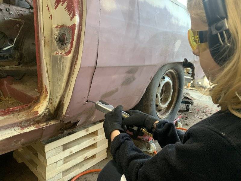

One car done!! Another car started my 10 year old son starting cutting quarter panels off . Good helper
Dual master cylinder is a problem. Asked someone what year had passengers side brake outlets and I thought I remember. Forgot 68 or 69 maybe a RR that has passengers side outlets. Move one of the relays for clearance. Now if someone will tell me what year and modal has passengers side master outlets i will bookmark it.View attachment 1599909

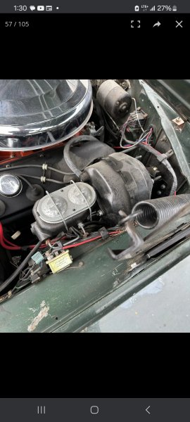

Drum brake master cyls ALL exit fenderwell side

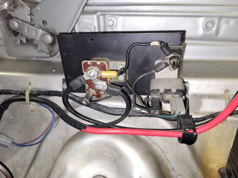

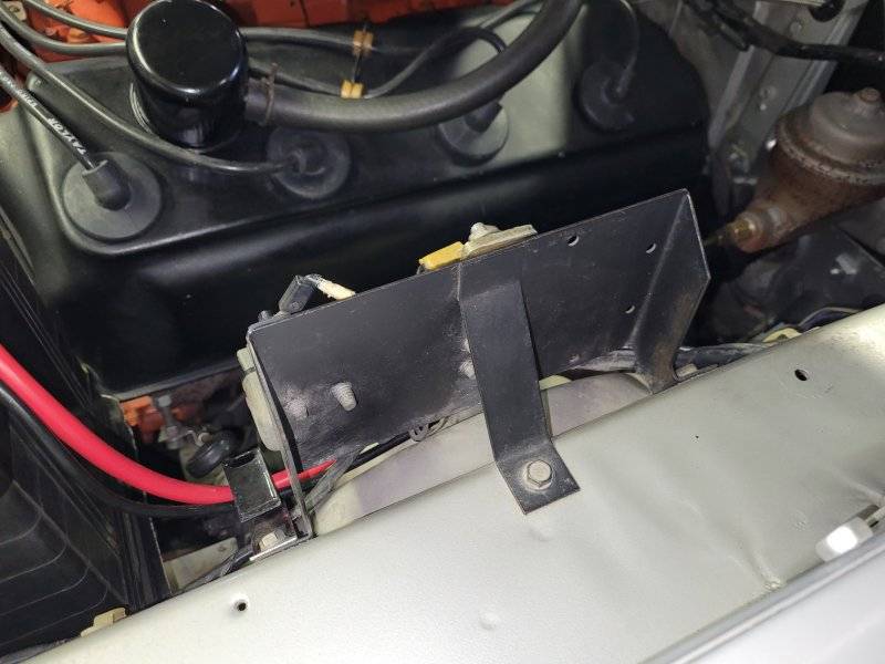

Possibly true, but zero reason you can't use the stock disc/drum '70 master and just stick a residual valve in the front lines outlet port if you want to get away from interfering with the '66 only starter relay assembly.
is this an original power drum brake car ????
