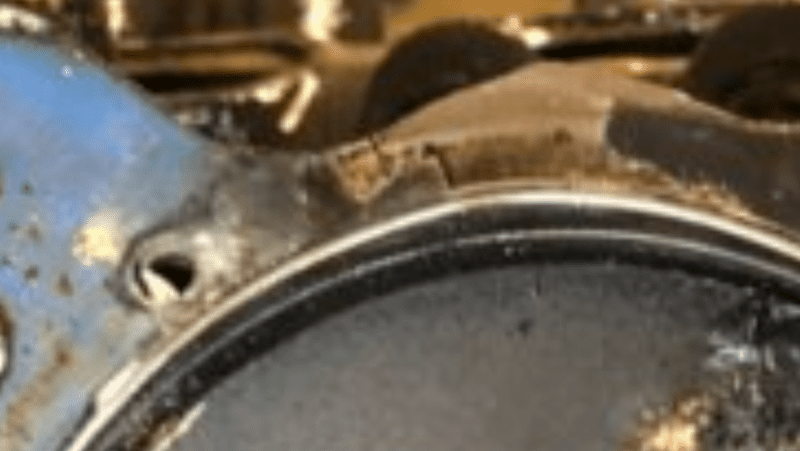

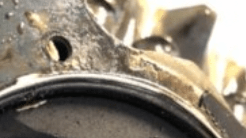

Not to come across like a dick..... but.......Imo, you guys scratching your head about where the coolant came from are blind.
Where do you think that little hole on the left goes?
There’s even a clear path along the gasket.
Absolutely no question in my mind where the coolant came from.

Yeah I know that’s why that pic was posted it’s just I wouldn’t have thought coolant would pass there since the gasket appeared intact to the hole but it’s true there appears to be a path there
You think that delaminating area around the coolant hole would seal up 15-17psi cooling system pressure?
Trust me....... It won’t....... and it didn’t....... as evidenced by the engine full of goo.
That’s not going to be a “leak”........ it’s going to be coolant injection into the crankcase.
Awwww lol it’s trueeee
View attachment 739340 View attachment 739341
Yea I wasn't looking at the pics really. I was more giving him ideas what to do when putting it back together. I agree looking at it that the gasket looks spanked. I figured he could find the leak looking in person. Usually pics are hard to see all the details.
I agree 100%. I just mentioned the timing chain cover as a check during disassembly. Many times it gets over looked.
