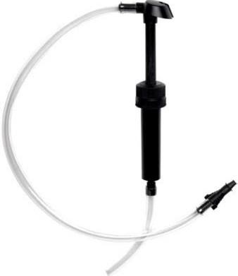

You can use something like this one. Auto parts store, Walmart ect. Then you can use it to pump the new oil in...

You can use a vacuum pump - looks a little like a grease gun....with a long clear hose. Go through the filler bung and suck that oil out. If you suspect any debris, pulling the pumpkin is your best option. :thumbsup:
