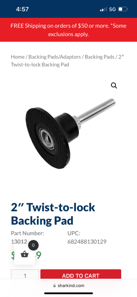

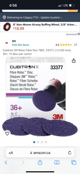

I Like 3m cubitron 2” rolloc, they come in bigger sizes , the twistloc backing pad is how they mount. The 3m purple cubitron lasts the longest in my option and doesn’t fly apart. I bent the shank on the mounting pad once but it was a cheap one. 3m is more money but it lasts longer. With a good pad it’s flat not dished. I found the the 3m pads last way longer. If anybody is using different pads that cut well for a long period this would be great information. The 3m stuff is pricy!
Another technique when using air angle die grinder is keeping the backing pad flat. It will dish the sheet metal if used.

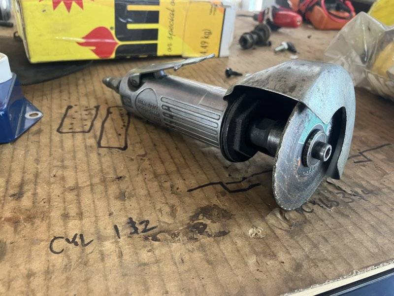

What I use to knock down weld beads is a hard wheel on my die grinder. 3" X 1/8". Heat is your enemy and by
using the edge of the wheel you can knock down the high spots efficiently and you have alot of control. Anything
else just wears out fast and makes heat.
The main issue when working on sheet metal and grinding, etc, we know heat is your enemy, so go slow, bounce around in your work area, resist getting aggressive.
3 inch x 1/8 wheel on a die grinder; followed up with 24 grit 3 inch roloc disc
else just wears out fast and makes heat. View attachment 1706507View attachment 1706520

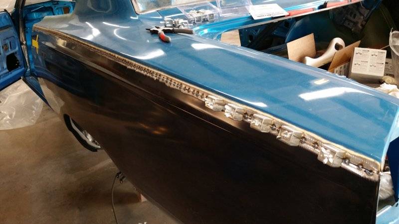

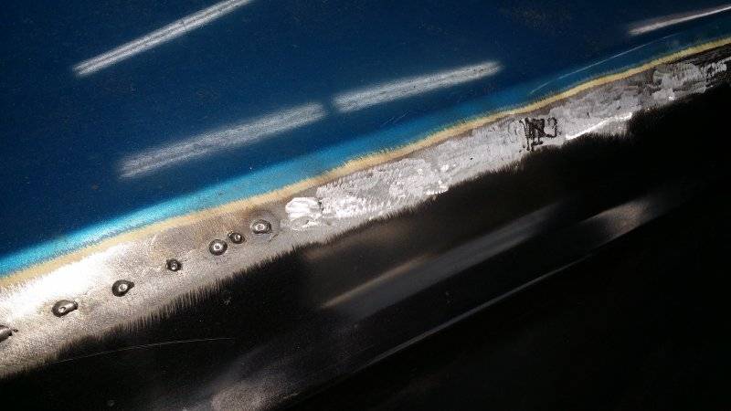

Here is my winner! The only thing I do a little
different is use a 3 inch air cutoff saw with a
3/16"- 1/4" thick 3" diameter 3M hard wheel.
You have variable speed doing it this way.

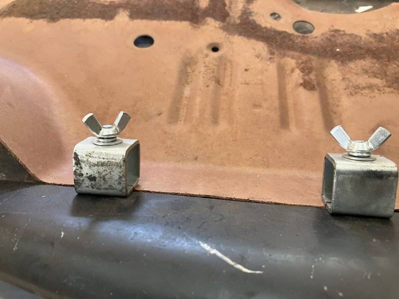

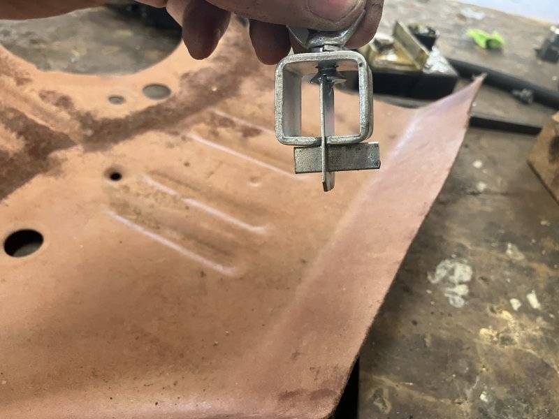

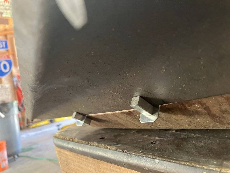

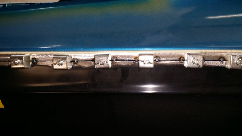

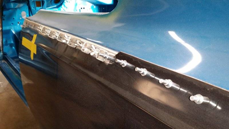

I have no immediate plans to cut and weld anything. I’m just trying to improve my skills to make things easier later.

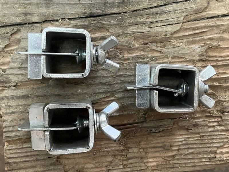

I bought these things…
The thin and flat plates allow a small gap that gets filled by the welds.
To use these things, you’d need access to the back side of the panels.
I’ve done lap welds for patch panels but it seems that butt welds reduce the risk of corrosion forming.
