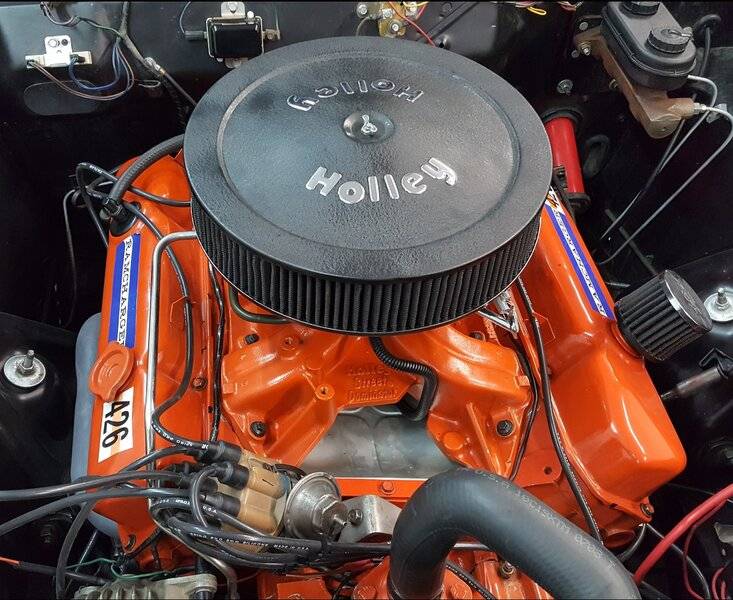

MSD 6AL with a stock, recurved distributor. Mini starter. Fires INSTANTLY! Even friends with fuel injection are suprised how quickly it fires. If it's cooler I do half a pump on the throttle to get a pump shot into the intake.
What is your initial timing at?
I'm hoping the answer doesn't lie within a high energy ignition system as I've tried real hard to keep a factory appearance, but at this point if that's my answer I may just jump ship!
I have 36° total. With the lightweight springs in the distributor it pretty much just helps as a retard for starting and is all in at idle. My 6AL is hidden under the battery so stock look is retained.
I have 36° total. With the lightweight springs in the distributor it pretty much just helps as a retard for starting and is all in at idle. My 6AL is hidden under the battery so stock look is retained. View attachment 1187194
