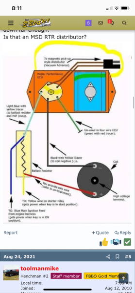

the wire has to be the resistor wire. the question is should i run the wire to the coil or leave it off. yes i will call pertronix.
Did you bypass the ballast resistor? Only need 2 wires on positive side of coil the one from the ballast and positive from petronix then negative to negative on coil need the proper voltage coil and bypass BR so you have full voltage at coil
Which unit do you have? I have the petronix 1 and use there1.5 volt coil
where the original wires you have go
i have the pertronix two with 1.5 coil. i did by pass the BR just wanted to make sure i didn't hurt the coil with full power.
Just don’t leave ignition on and car not running. Yes you want full voltage to coil
